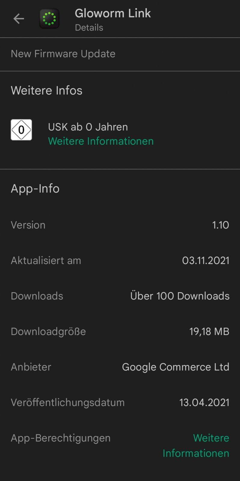

I would like to know that too. I'm relatively sure that I never saw anything about software updates in the app (Android). So no display / popup, and also no menu item with which I could check manually.
You should be notified automatically of available updates. The latest App update that has the latest FW update is 1.10. maybe a manual app check will be useful - we'll look into that!

Edit: Android version even older than ios
Hey - the reason that Andorid is behind IOS is that we had some extras issues with IOS that we did not have with Android. We have not released a FW update since this particular app update, so if it does not offer an update then your devices are fully up to do date. The flashing at low power is yet to be fixed, but we are working on it as we speak.

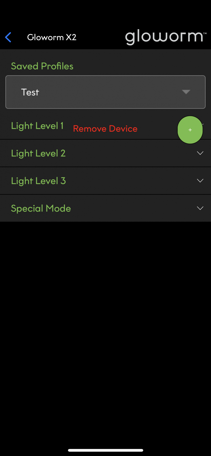

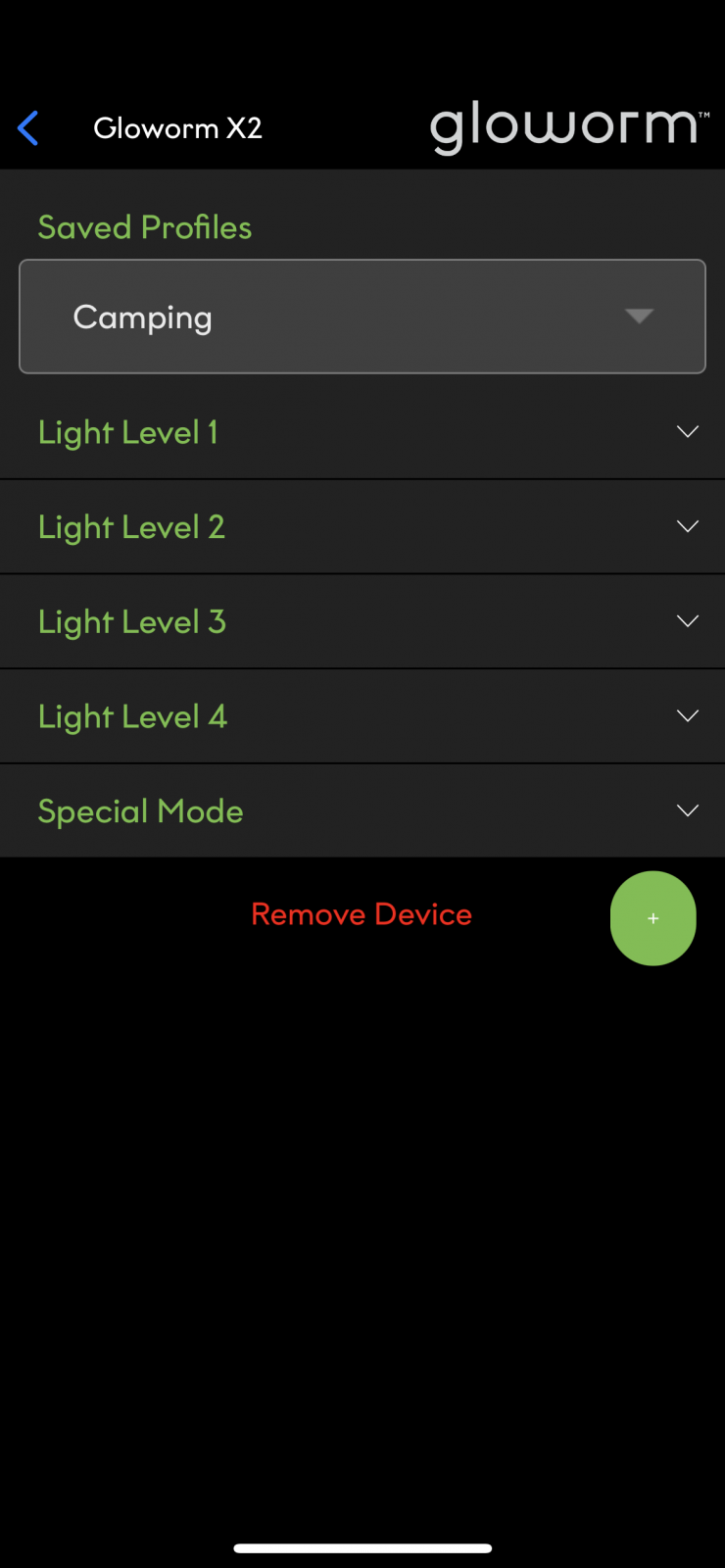

Regarding my problems with the iOS App on my phone:
When I'm connected to the headlight and switch between profiles in this screen:
The app switches to this screen and freezes completely:
Same happens when I'm creating a new profile, it freezes in this screen:
The only way to get it working is closing the app via the app rotation and then restart it.
Phone is an iPhone 13 Pro with iOS 15.1.1
Would be great if there will be a quick App Update to fix this.
