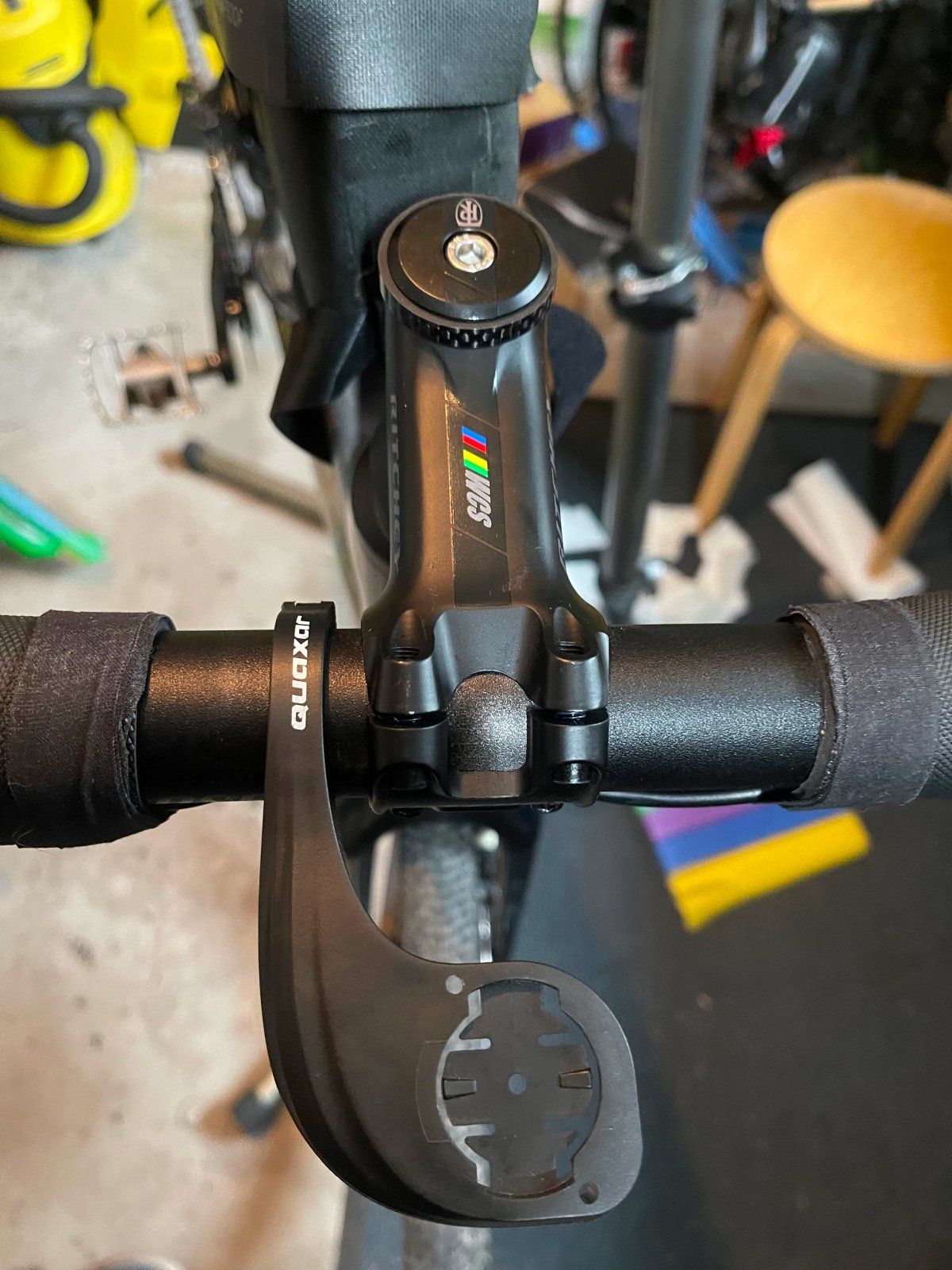

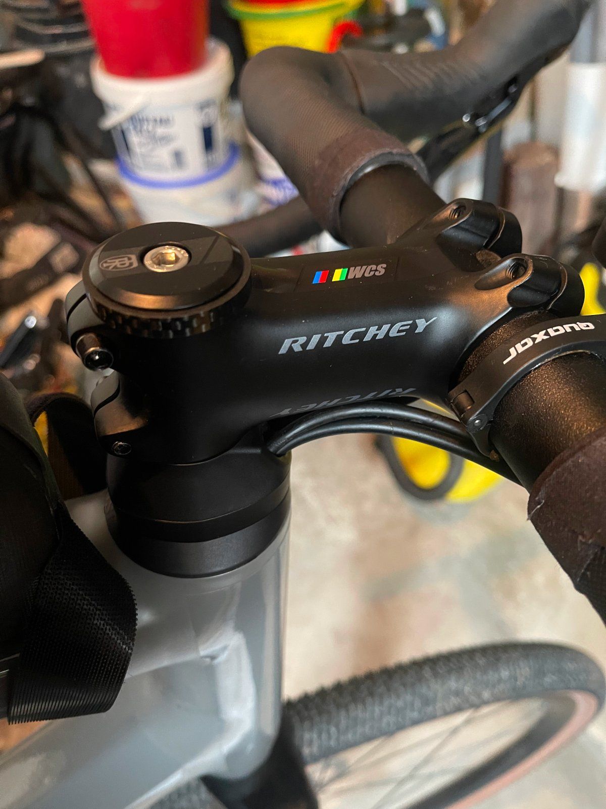

Soderle,
Vorbau ist getauscht auf nen 80er Ritchey mit der TopCover-Variante 🙂. Ist schon ne ziemliche Rauferei gewesen mit der Ab- und Aufwickelei, den Leitungen und Zügen, kürzen, entlüften usw.. Lecko mio, da ist nichts mehr mit mal-schnell-den-Vorbau-wechseln 😅. Gebraucht habe ich 2 Oliven, 2 PINs, 2 neue Züge, bisserl Mineralöl für die Bremse und halt den Acros TopCover und den Vorbau. Rest konnte ich wiederverwenden.

soderle,
Stem is exchanged on a 80's Ritchey with the TopCover variant 🙂. It's been quite a scuffle with the unwinding and winding, the lines and cables, shortening, bleeding, 😅etc. I needed 2 olives, 2 PINs, 2 new cables, a little mineral oil for the brakes and hold the Acros top cover and the stem. I could reuse the rest.

why they needed to cut the break cables if you installed a shorter stem ? new pins and olive, the old ones were unusable ?
During the assembly of the brakes the olive gets compressed and some kind of bond to the pin and the part of the hose which is between them. At best you can dremel the olive split it and cut down the damaged/compressed part of the hose to extract the pin which is indeed reusable. But it‘s the only part which is reusable with a high amount of work/patience etc. And since you can get those pins and olives quite cheap at aliexpress i see no reason to do all this just for one pin.
Edit: You have to cut the brake hose because they go right through the stem.
One point is the shorter stem. First I cut only 2cm because of the 2cm shorter stem and tried to assemble the brake. At this point I saw, that the cables were still too long to fit. That's why the way the brake cables need to get through the integrated stem, is much longer than the way they need to go directly out of the topcover to the handlebar. So I had to cut them once again for ca. 3cm. The cables need to be cut because they are very stiff and if they are too long there's no chance to lay them in a good way and to wrap the bar tape.
The rest is already perfectly answered by @tomdoe :daumen::) . Because I had to cut the cables for a second time and had only two pairs of pins and olives which I had already pressed in, I took a sharp cutterknife and cut open the part of the hose, extracted the pins and reused them.

One point is the shorter stem. First I cut only 2cm because of the 2cm shorter stem and tried to assemble the brake. At this point I saw that the cables were still too long to fit. That's why the way the brake cables need to get through the integrated stem, is much longer than the way they need to go directly out of the topcover to the handlebar. So I had to cut them once again for about 3cm. The cables need to be cut because they are very stiff and if they are too long there's no chance to lay them in a good way and to wrap the bar tape.
The rest is already perfectly answered by @tomdoe :thumb::) . Because I had to cut the cables for a second time and had only two pairs of pins and olives which I had already pressed in, I took a sharp cutternive and cut open the part of the hose, extracted the pins and reused them.
Thanks for the explantation, it's very clear !

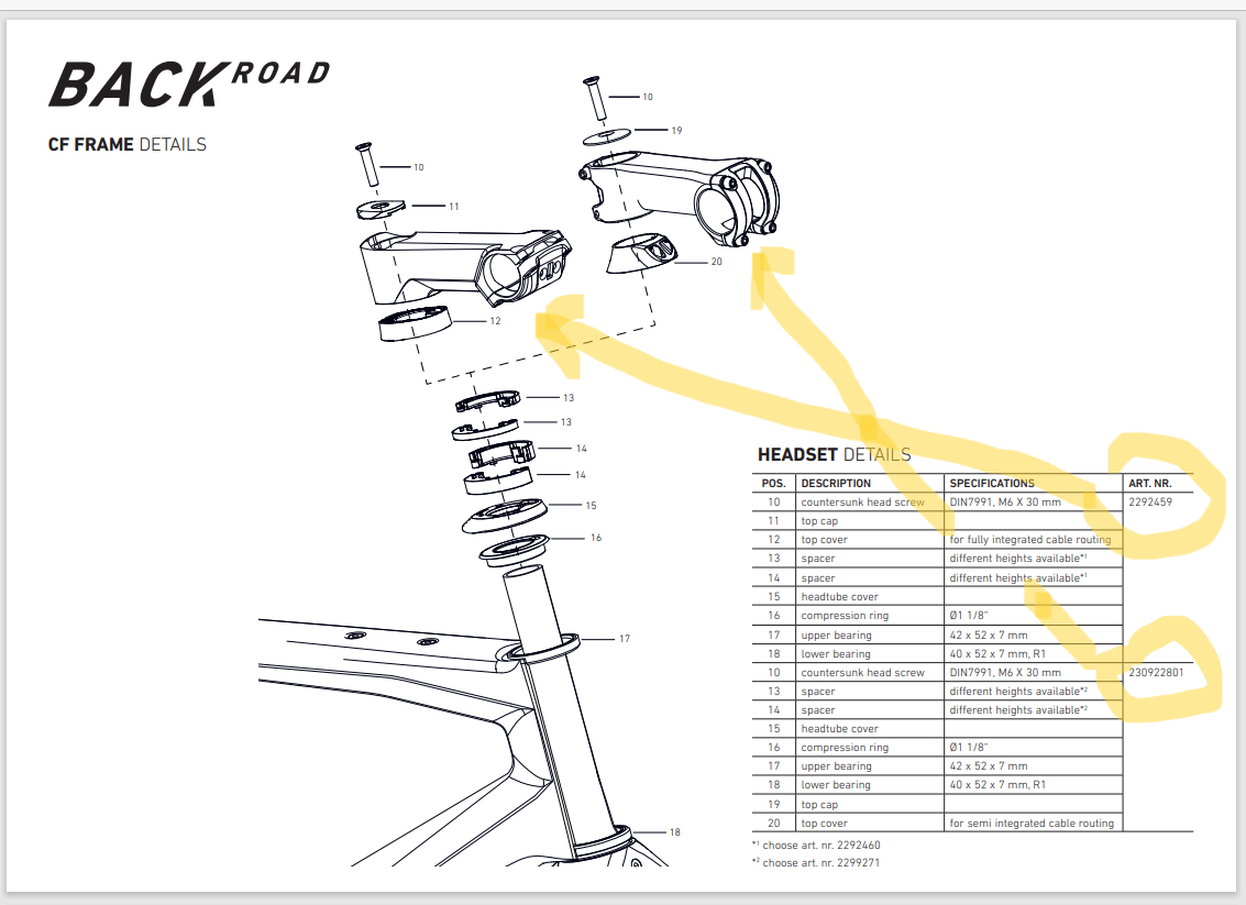

Was the number of the old headset was #23092280? if you check in your oder basket ? Thanks
Edit 19.11.2022:
Hm. Yes, of course (with a 1 at the end missing in your number), if you meant the former headset from the 2021 Backroad with semi integrated cables. This one i ordered and built in.
Here's a picture that shows both headsets including the parts numbers:
This was sent to me directly from Acros to make sure that I'll place the right order.
