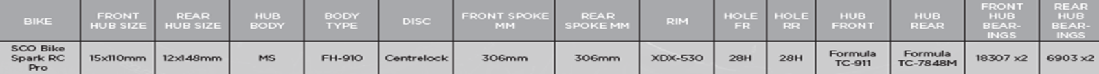

Mit der 240er Nabe sollte der SL 1645gramm wiegen. Das wäre das oberste Limit welches ich akzeptieren würde. Preislich derzeit jedoch sehr interessant. Der mit 350er Nabe ist derzeit wohl bei ca. 660€/Satz zu haben. Der wäre aber dann für mich "zu" schwer.
Wo gibts den Satz für 660€?
50g Unterschied im Zentrum vom Laufrad, noch dazu bei einem Traillaufradsatz? Naja, wer’s braucht…
Und Mavic wäre das letzte daß ich mir freiwillig und selbst bezahlt ans Rad schraube. Sowas fahren doch gezwungenermaßen nur gesponserte Leute…
I replaced the Syncros Silverton 1.5 on my Spark Pro with a set of Elitewheels 29er Pro36. 1510gms with their inhouse Pro hubs (DT Swiss hybrid clone), $739 and 3 year warranty. They now have a more expensive Gnar Trail SR $839.00 available. You can get a 15% discount code to reduce the prices. I changed the Recon Race with a pair of Maxis Forecasters for all year round trail use and improved grip.
Which hubs does the Syncros Silverton 1.5 have and how heavy is the wheelset?
Mine weighed 1800gms.

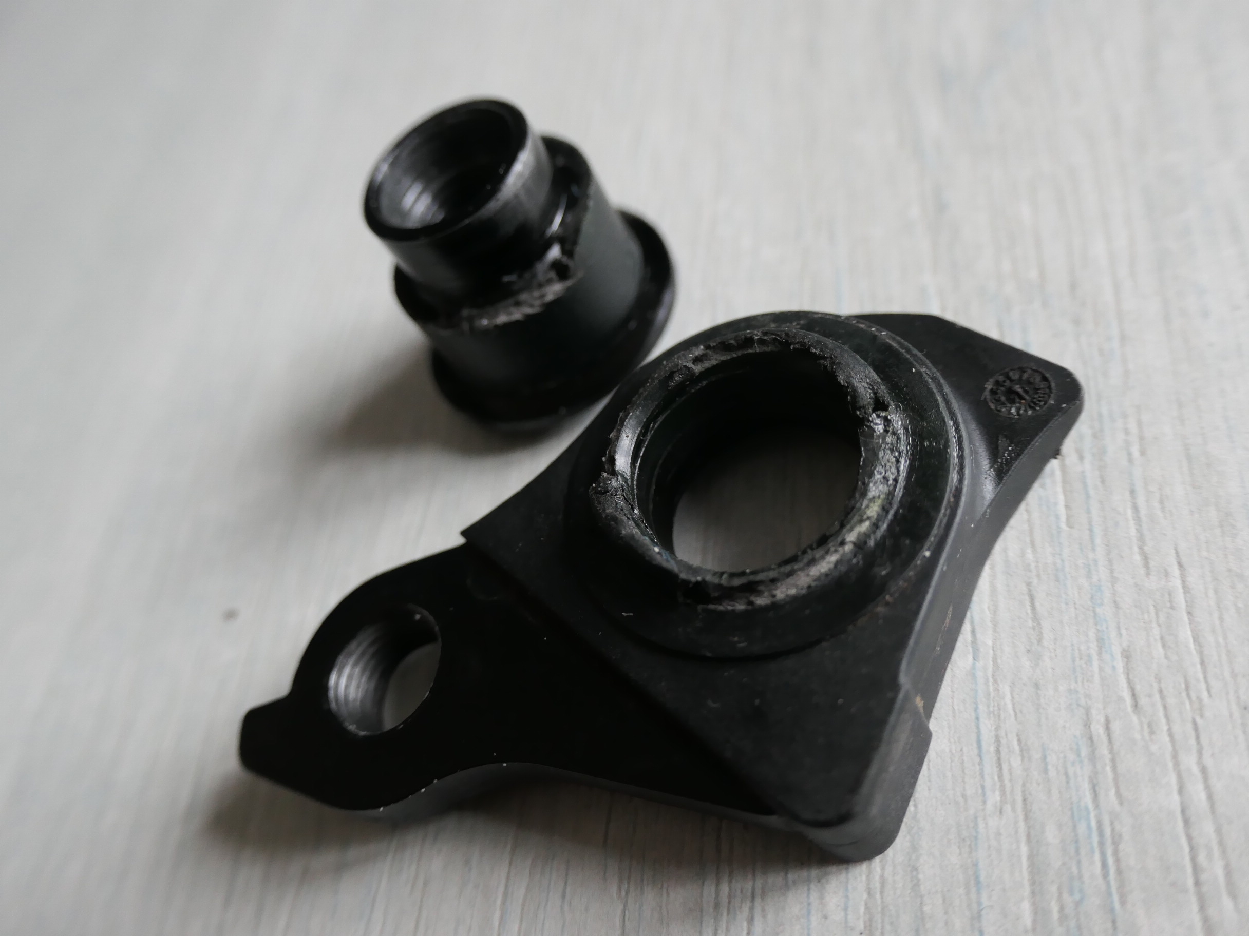

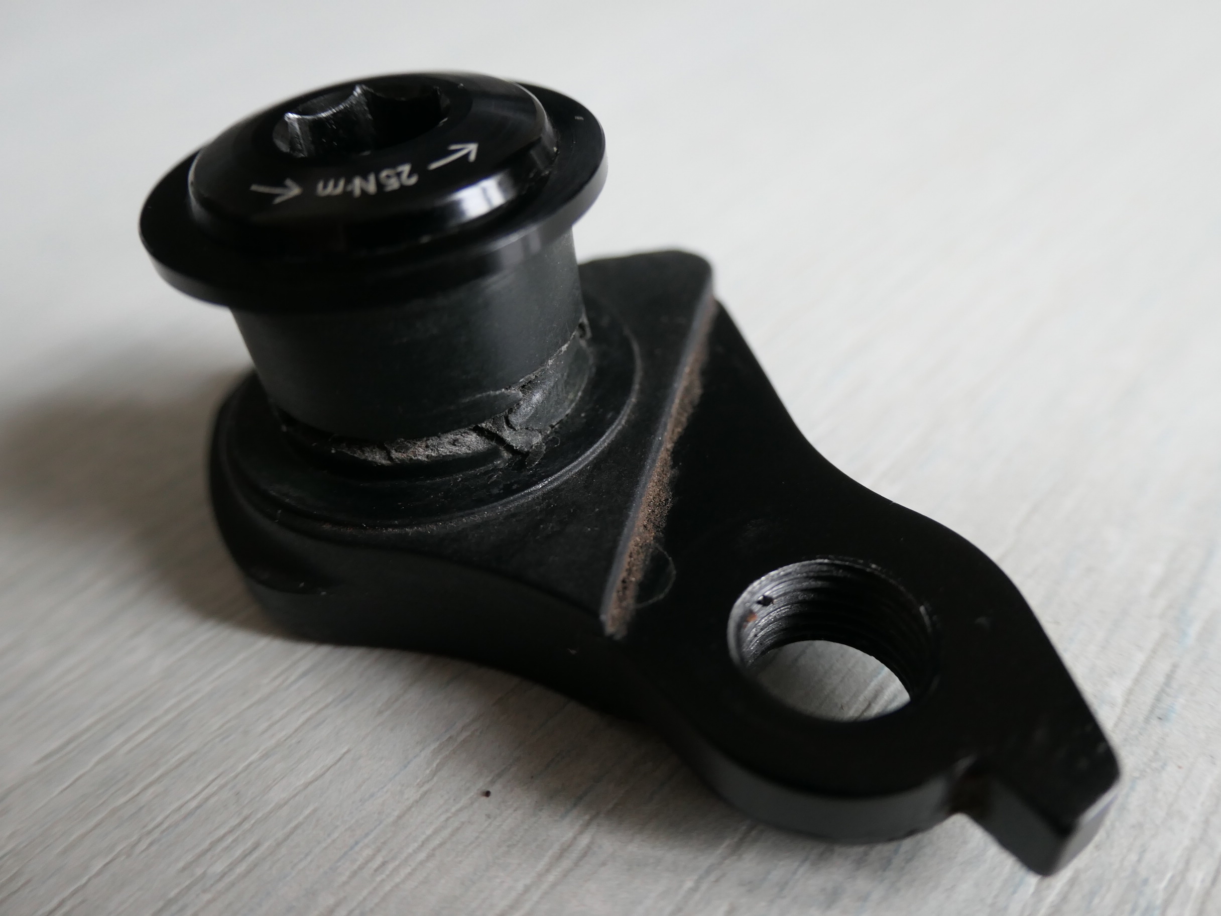

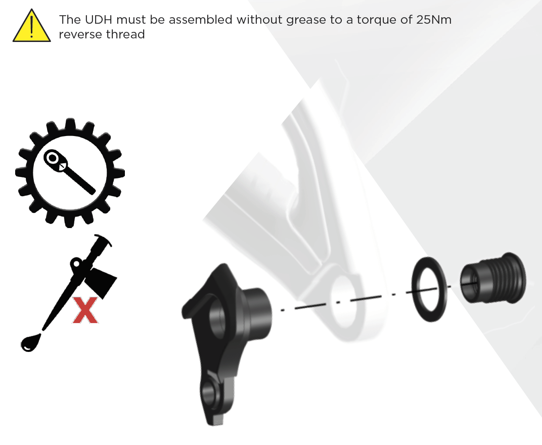

I finally solved a creak that had appeared when pedaling hard. The part "286000 - SCO Dropout Sram UDH 21" had split but I had not noticed. It had completely torn apart and I only found out when I saw the bolt turning when tightening up the wheel axle after replacing the wheel. It requires a torque setting of 25 Nm, has a reverse thread and needs to be fitted without any grease/lubrication. Replaced with new part and the creaking has stopped.
I finally solved a creak that had appeared when pedaling hard. The part "286000 - SCO Dropout Sram UDH 21" had split but I had not noticed. It had completely torn apart and I only found out when I saw the plastic bolt turning when tightening up the wheel axle after replacing the wheel. It requires a torque setting of 25 Nm, has a reverse thread and needs to be fitted without any grease/lubrication.
Anhang anzeigen 2023661Anhang anzeigen 2023663Anhang anzeigen 2023670
That’s a good point, thank you.
I would also like to add that the part is the SRAM UDH (Universal Derailleur Hanger), which is widely available.
