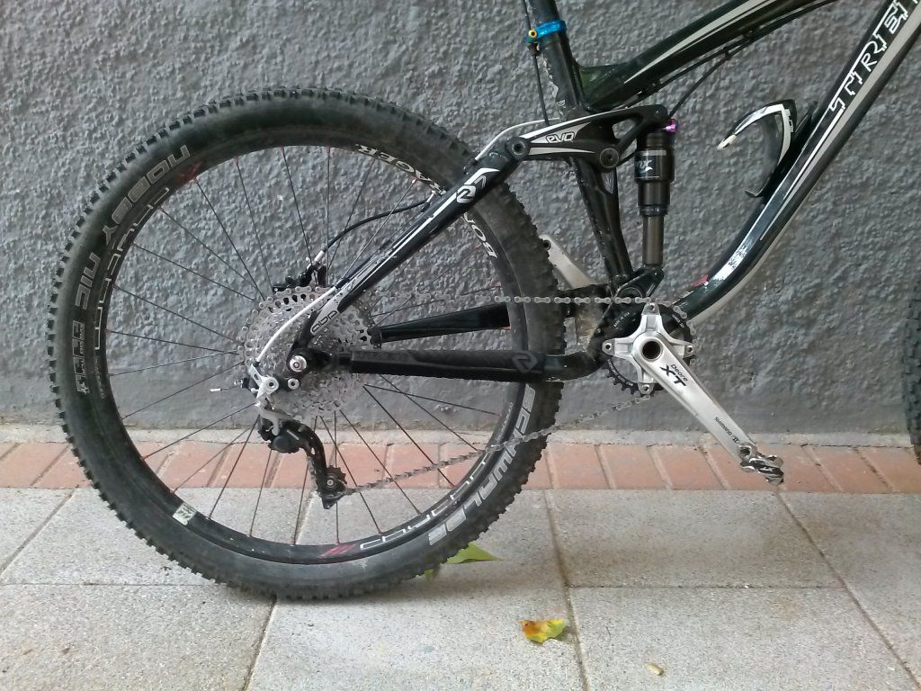

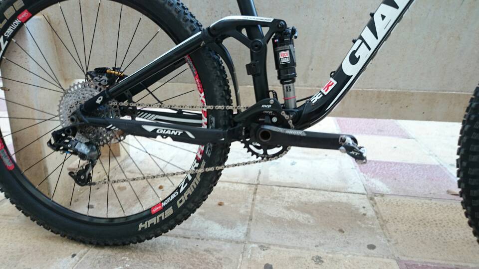

Sehr interessantes vid, 1x11 mit XT schaltung
Yes!! It's my video. 11 speed cassette with custom 42t cog and upgraded to 11 speed Sram o Shimano shifter.
