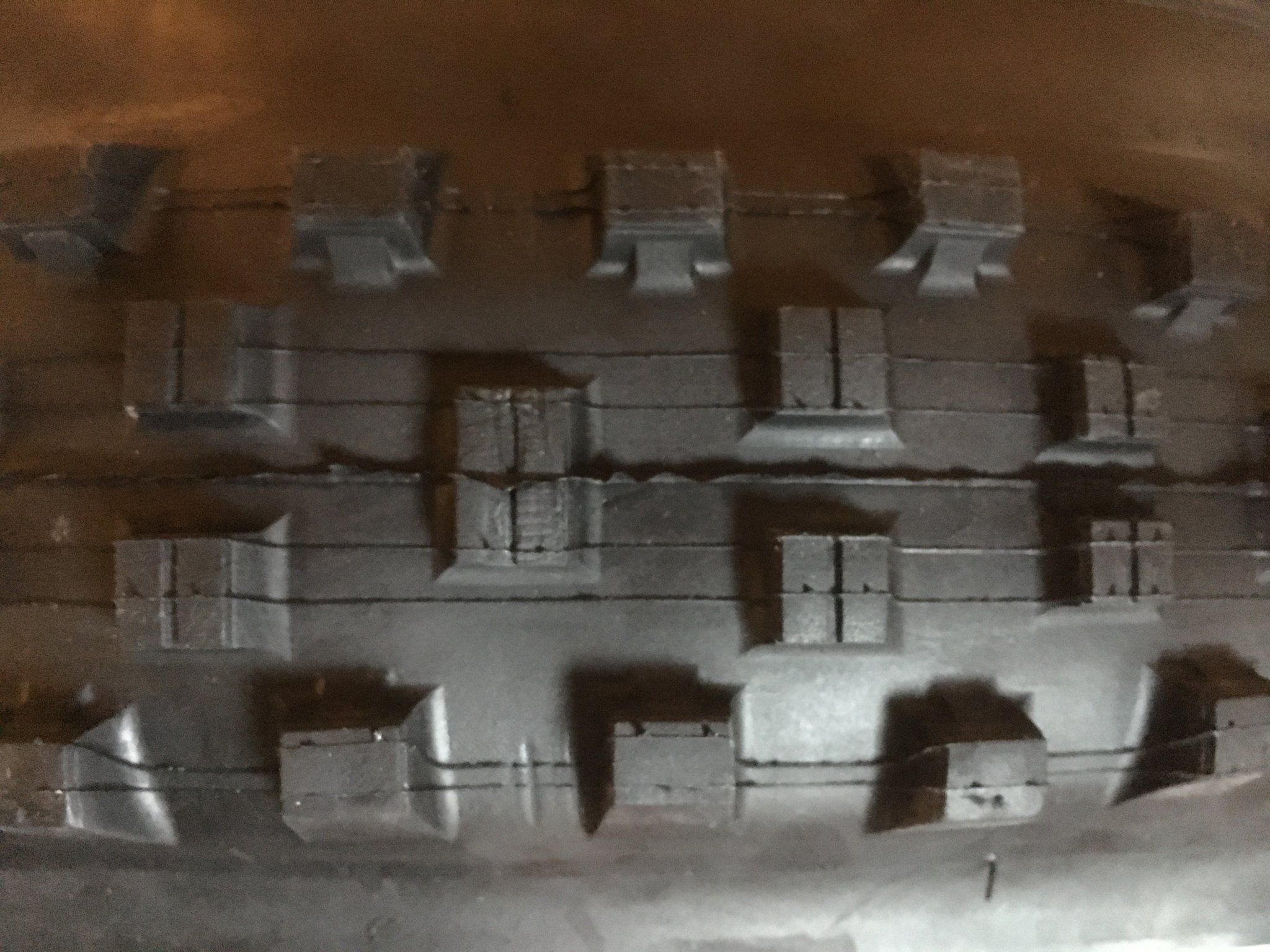

Apropos Maxxis:
Ready for Devilclipping...
