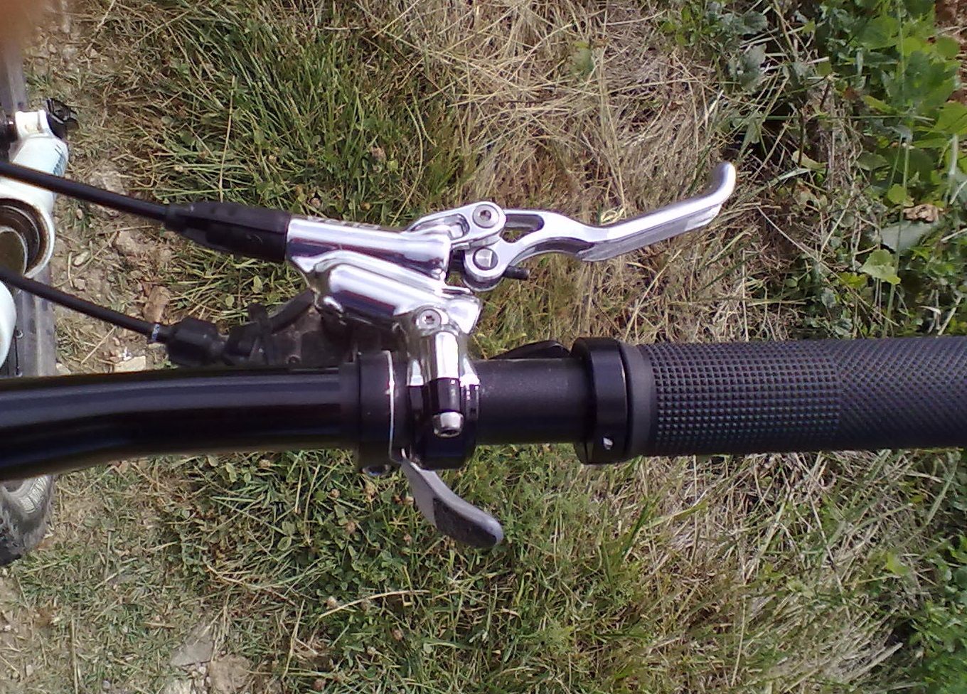

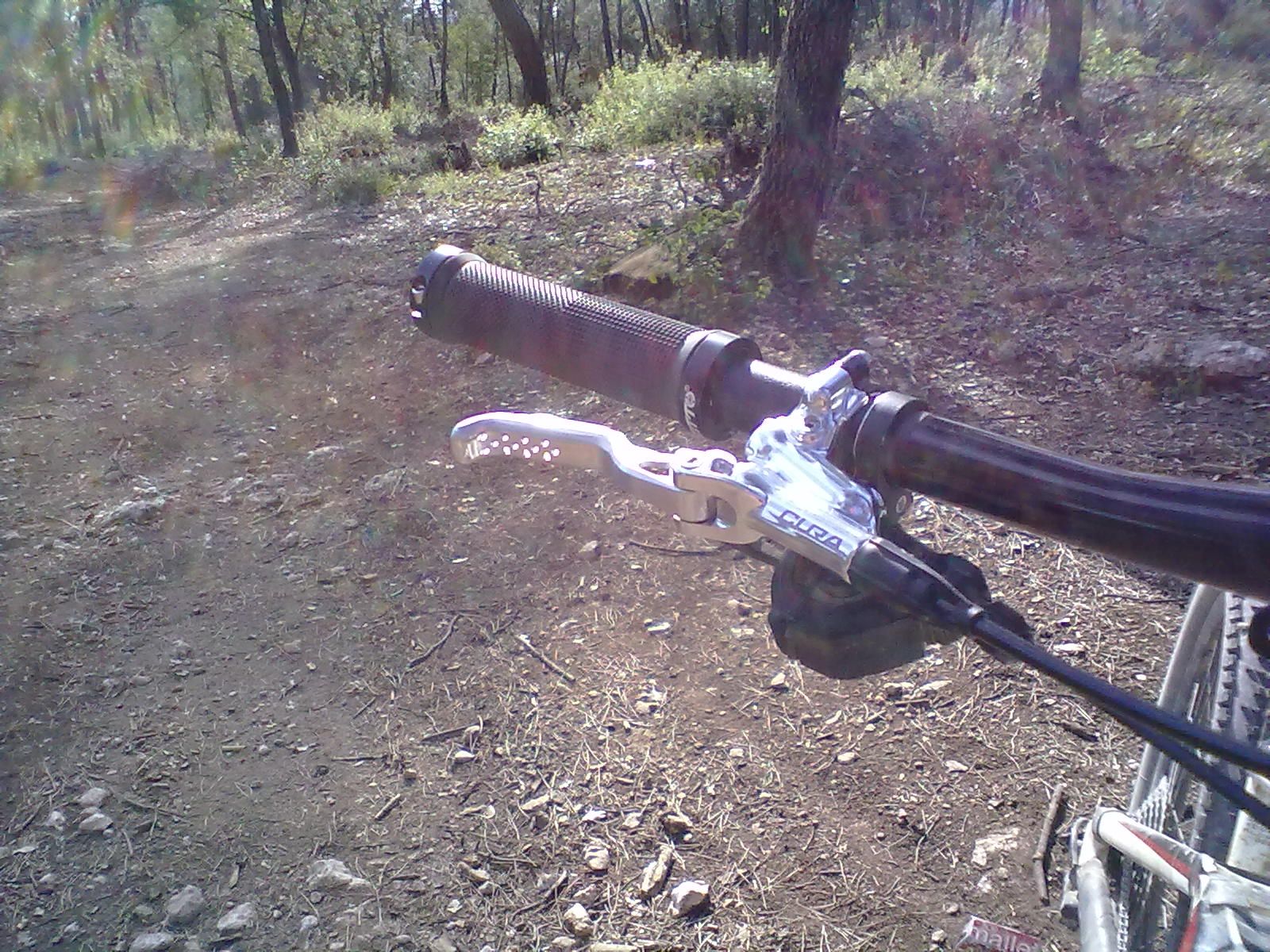

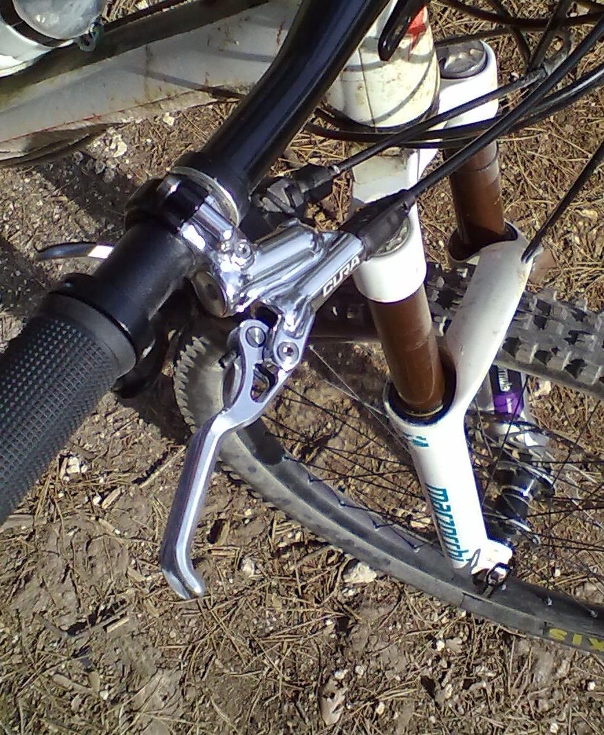

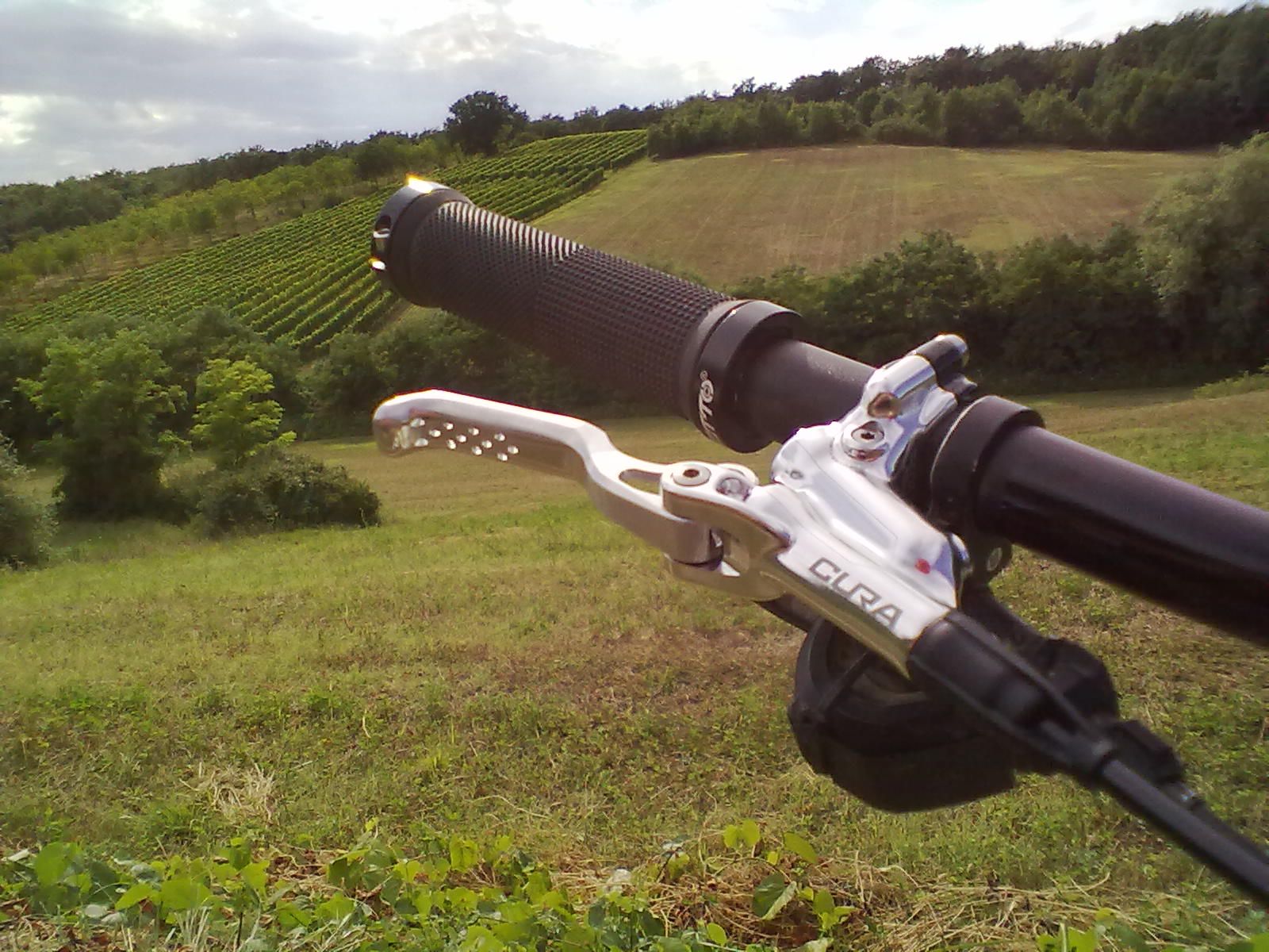

I'm sending a batch to anodize in a few days to avoid getting caught in the summer closures. Any interested buyers please let me know as soon as possible. Also because I didn't make a lot of them, and probably won't be able to make another batch in the future.
Gold, silver, black, violet (glossy or opaque, see pic) but also other colors.
When u compare them to the stock levers, what is different?
The shape is identical. Weight and stiffness is the same. The drilling on the finger makes them grippier (the holes edges are raw, not beveled). I only made them a bit thinner at the finger: 13mm instead of 14, because it seemed a bit too bulky (on another bike I have 12mm levers and I like them)
