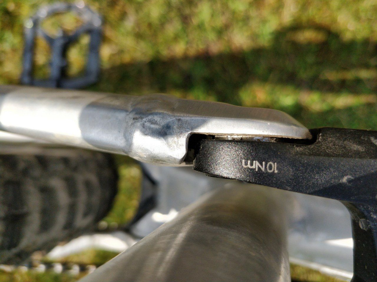

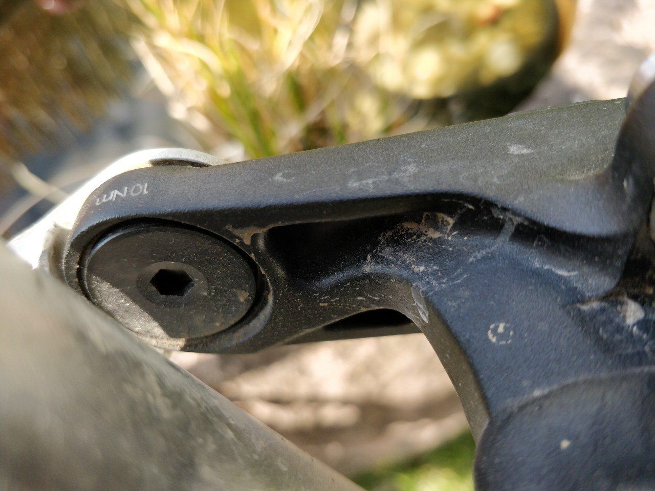

I had a look at my 601 and everything seems OK. I never had any creaking or any trouble with the bearings. With 'L' size frame there is no way the RS Deluxe conflicts with the tube. My frame was build May 2018 - probably your charge was bad or I am just lucky.
IMAGE 2020-03-20 15:06:36.jpg
IMAGE 2020-03-20 15:18:33.jpg
In some frame sizes in normal orientation shock doesn't fit (601-Mk14_Daempferupdate_02.pdf ).
I think that is problem on smaller frames mine XL fits SuperDeluxe in normal orientation - I prefer it because of shock lubrication and easier access to propedal lever (my frame is april 2018 and I drive in lowest setting 601 Mk4 SuperDeluxe_normal orientation.JPG ). According to
Blue Rabbit it also fits on size L.
