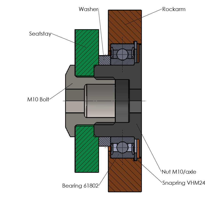

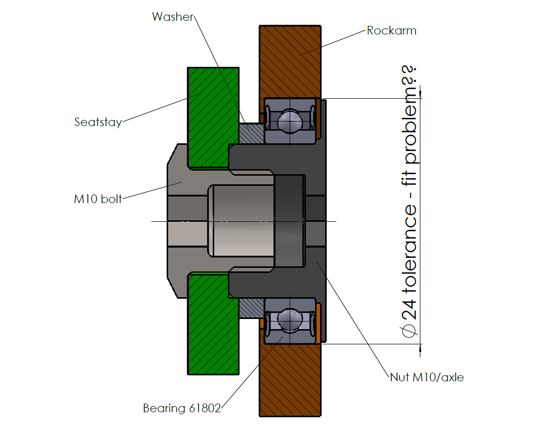

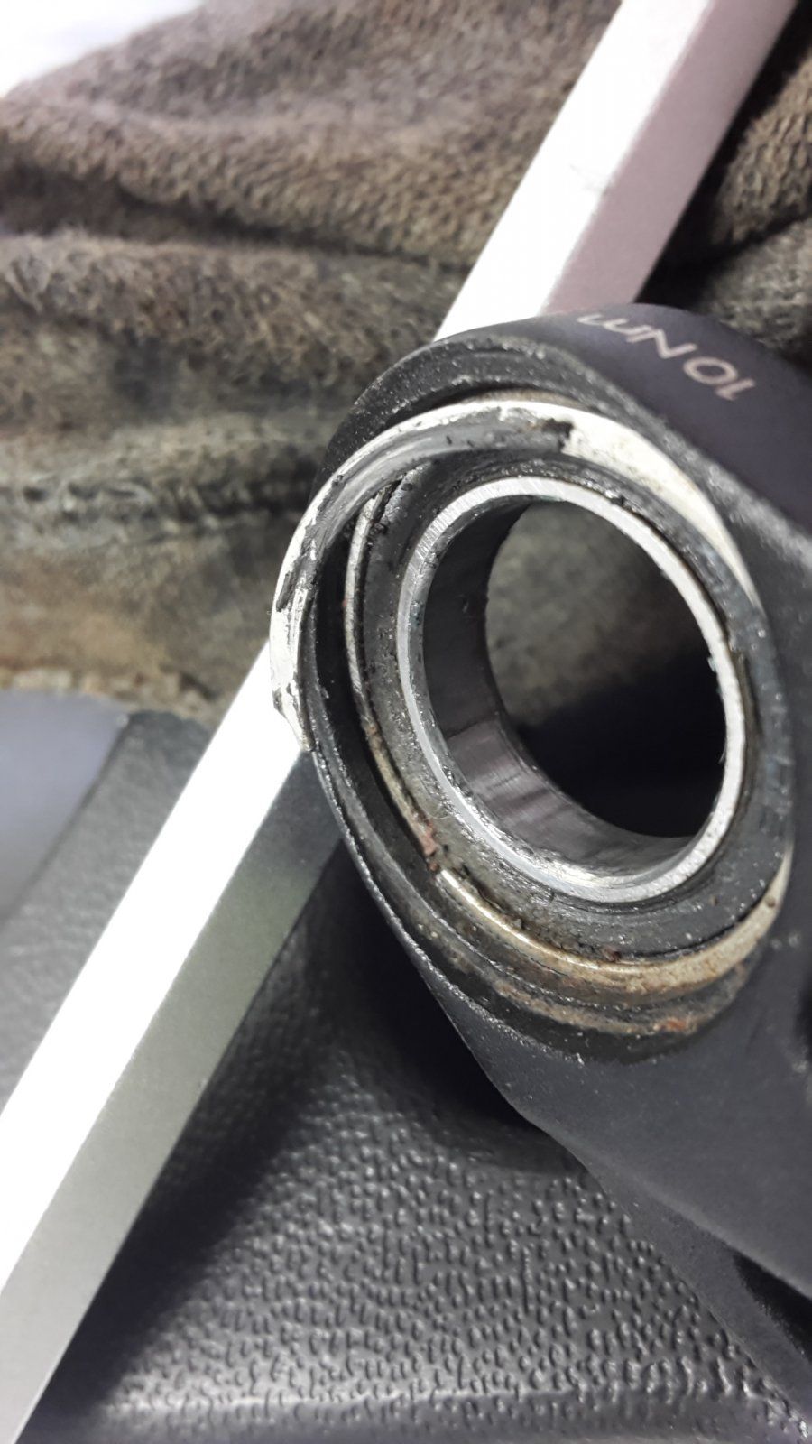

Blue Rabbit : I have different experiences with 601 Mk4 - this is my third Liteville frame (Mk1 cracked at headtube gusset after 5 years, Mk3 cracked at derailleur hole on chainstays) and the worst if I look from construction and reliability perspective (although it goes up and down better than Mk1 and Mk3).
All users of 601 Mk4 I know personaly, have or had problems with rockerarm - bearings are moving (wrong design and tolerances......). Liteville gives you new rockerarm with snaprings (but also this version doesn't work always - if I remember correct I am on my 4th rockerarm, repaired/remachined chainstays......).

If we are talking about problems - look attached pictures.

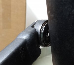

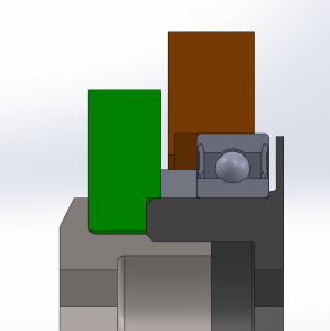

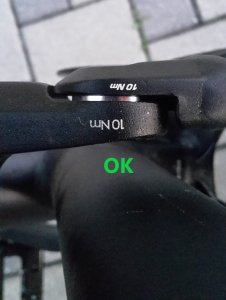

For all owners of 601 Mk4 look at seatstay-rockerarm gap (attached picture Seatstay-rockarm_not ok.jpg ok and Seatstay-rockarm_ok.jpg ). I think many doesn't care about creaking and some details on their bikes - and they also don't know that they have this problem. Check the gap, if it is smaller than on picture Seatstay-rockarm_ok.jpg you need to contact Liteville - in my opinion they should contact customers about this problem (in similar way as they sent instructions how to mount RS Super Deluxe - because of possible contacts with frame).
I have also attached some other pictures that you can understand this problem on Mk4:
They use symilar system on 301 but with one important difference: on 301 left and right seatstay are conected (one part), on 601 Mk4 left and right seatstay are two parts......
