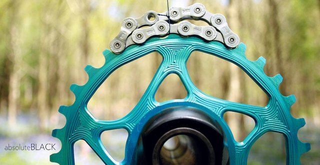

Please note that thick-thin profile is not necessary to hold chain like XX1 IF tooth profile is corect. We have discovered that simple principle with new tooth profile which allows to bring the costs of manufacturing down and keep the chain like on XX1.
Our tester - XC Slilver World Champion, multiple national Champion and CX National Champion Marek Konwa has been using it for 4 months now and they perform great!
The principle of that is simple. We have achieved incredible tight profile of tooth to mesh with a chain. It goes in very smoothly, but when meshed with chain it holds it extremely good. In addition tooth profile is directional! That means it prevents the chain from coming off when back pedal or not pedaling at all while descending.
This is to show how good retention this chainring has. It's all about the tooth shape which can keep the chain in place. Only 4 links is enough to hold onto absoluteBLACK chainring!! Regular chainrings require at least double that.
http://absoluteblack.cc/sram-spiderless.html
Try to do it with yours and see result.
So to conclude - you dont have to use chainkeepr with my chainrings at all.

Hello Marcin, nice to hear you. I ordered a chainring from "you" just last week. Thank you for your very detailed and informative answer. It clarifies a lot. Is that chainring on the lower picture blue or cyan? By the way, very nice photos!
Edit: One more question. The chainring teeth on the new photos are looking wider than on the old photos. Is this a new version?
Edit Edit:
I have also figured out that you all are reffering to my old photos. Photos on my site for Sram spiderless chainrings are a bit old - sorry.
What you buy is that above!
Thank you that you have sorted it out. We took the photos from here http://r2-bike.com/absolute-BLACK
Edit Edit: Thank you that you have sorted it out. We took the photos from here http://r2-bike.com/absolute-BLACK
thanks. This time blue came up more cyan:/ but still looking very nice in real life. It's quite hard to control blue color on material i use so it's a bit of gamble each time i do it. Black and red are easy so i will stick with those i think for the future.
Yes that is the new tooth profile. That's what you will get as well.
The confusion comes from that i have been making regular tooth profiles for a while before launching that one. So there are still many photos on the internet with my old style tooth shape. I will do studio photos of the new ones this week and will ask Robert to update pictures as well:)

Klar ich meine nur wenn da 51mm stehen und dazwischen kein Spacer ist wird man auch nicht mehr viel machen können. Ich war eben mal im Keller und hab das bei mir angeschaut. Mit meiner 970er Kurbel auf 2fach, habe ich 50mm Kettenlinie und fahre hinten 9 Ritzel.
Wenn ich bei dem AB Kettenblatt wirklich nur 4 Kettenglieder brauche wär das schon magic ;) Hab das mal mit einem gewöhnlichem versucht. Man braucht schon so um die 15 Kettenglieder.
hehe das wird jetzt wohl ein neues Testverfahren.
"Fritz: und wieviele Kettenglieder brauchst du?
Klaus: bei mir nur 4 :D!!!
Fritz: ha! ich brauch nur 1:cool:
Klaus: :mad:"
dieses Absolute Black sollte wohl mehr können als das XX1...Theoretisch müssten die par Verdickungen ja schneller verschlissen sein.
Naja, ohne kleines Blatt und Spider dazu kannst du mal die Hälfte der Glieder wegrechnen...;)
