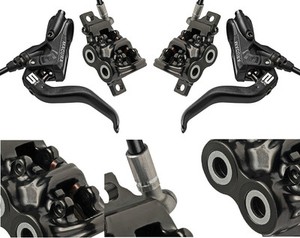

    - Brakes I just had a gread deal for a new Magura Mt5 set so I'll keep my SLX on the Explosif

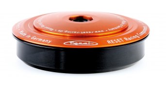

    RESET RACING FLATSTACK HEADSET (superlow stack height, 3.5mm upper/2.5mm lower, I have a rather short fork steer tube), black/orange
