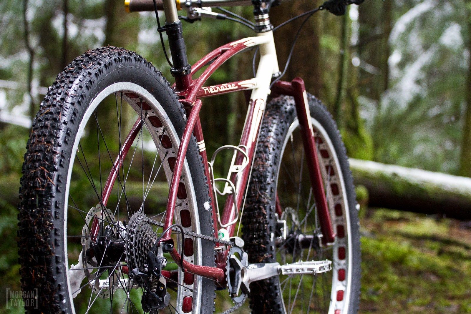

Not a single bike in that set, but there are design features I want to go for as I love these old Gassers and Flattrackers (never mind the Porsche, there for the color): think old shit that has been tuned and customized a few ticks too far, roaring V8's sending pebbles of rubber in your face as a junky piece of scrap metal hooks up and sends into a wheelie down the track...no Tesla can give me that kind of sensory overload. So, old shit that goes like stink, retro with modern performance, this has to be a core theme for the build...and with this the Stooges coming out of Andy's mind has a lot of appeal: steel frames with slack geo, modern disk brakes, possibility to run a dropper post and SS, a bi-plane rigid fork and tire clearance for 29 x 3 and beyond. For me that has got to be the Hotrod of the bicycle industry.
What about this ochre color? Is it curry, a deep mustard yellow, or simply what you find when you open the baby's diaper? I am not sure, from the few photos I have seen online the shade is not quite clear to me, and maybe not super-easy to find an accent for. But, I am thinking silver (brushed or polished) or maybe a platinum/gunmetal for the components, with some black (tires, grips, cable housings). It would be great to build up a wheelset with silver rims, getting some in at least 35mm inner width will be a challenge though.
I ordered the Stooge Junker bar (100mm rise), but I will probably do a few mock-ups with other bars as well. Sitting and staring on the bike with a coffee in my hand will happen, it will go through iterations and I also hope you bastards fellow forum members here will provide valuable input and mislead me on the way to get the Gasser-look right.

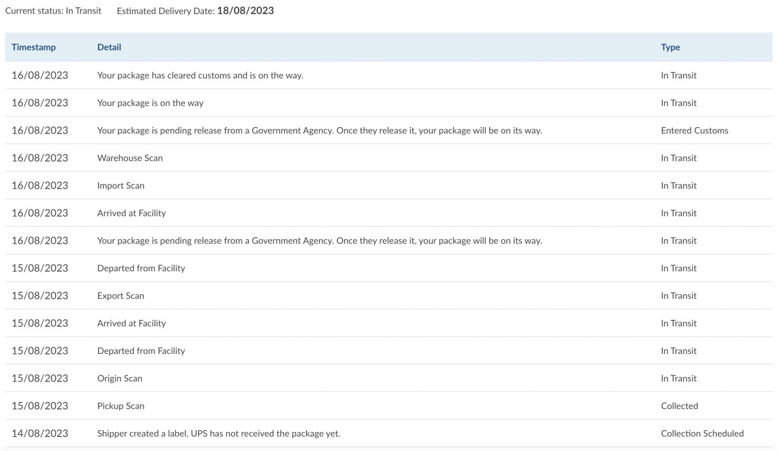

According to the tracking status it looks like it will be delivered this Friday:

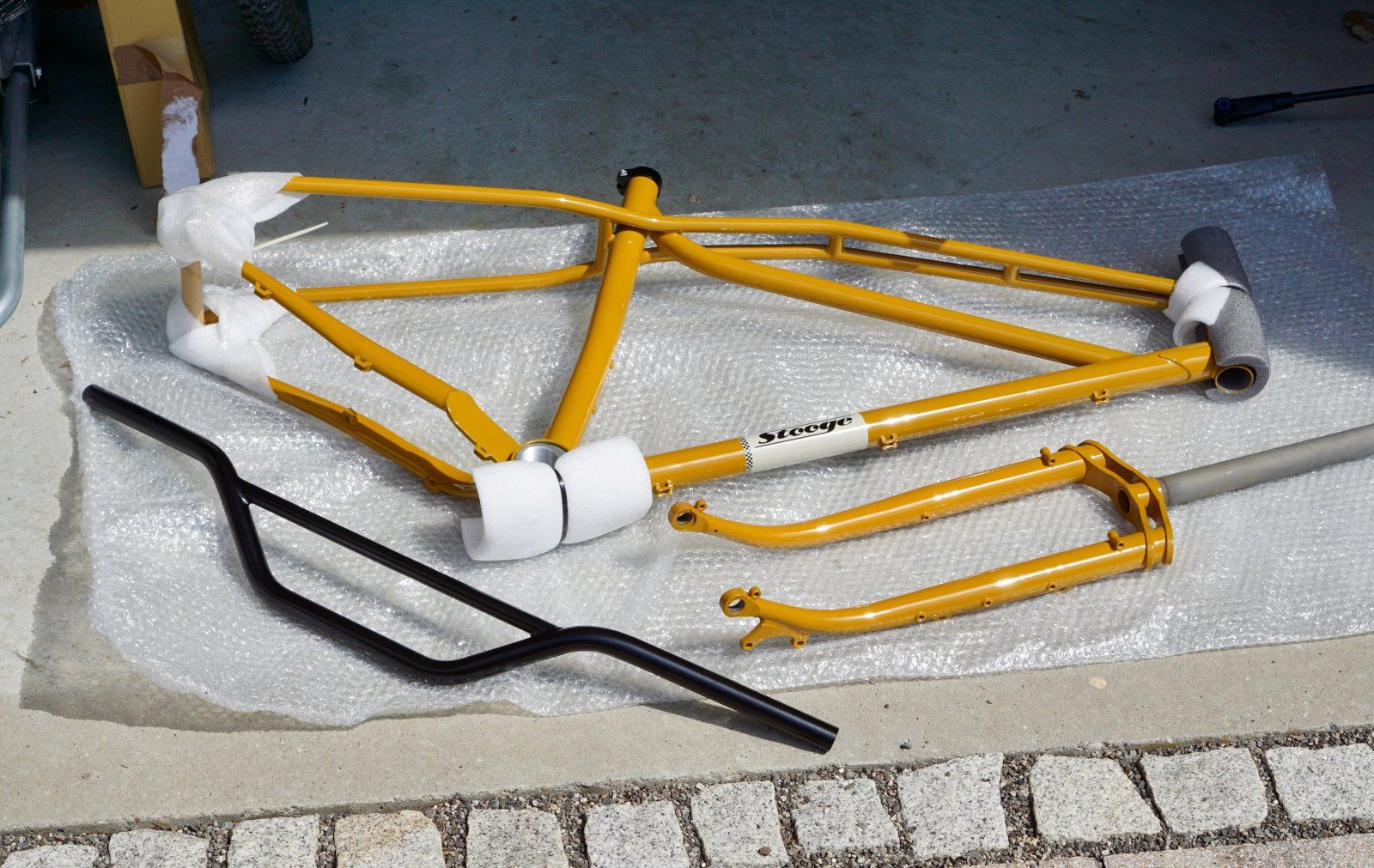

Heute ist das Paket geliefert, keine Schaden und den Rahmen und Farbe sieht einfach geil aus. Ich denke die Idee mit silberne Teile lasse ich erstmal: mit einige schwarze Teile aus die Restekiste mach es mehr Sinn es in schwarz aufzubauen.

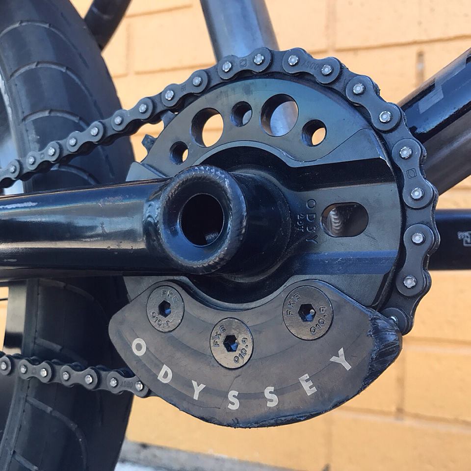

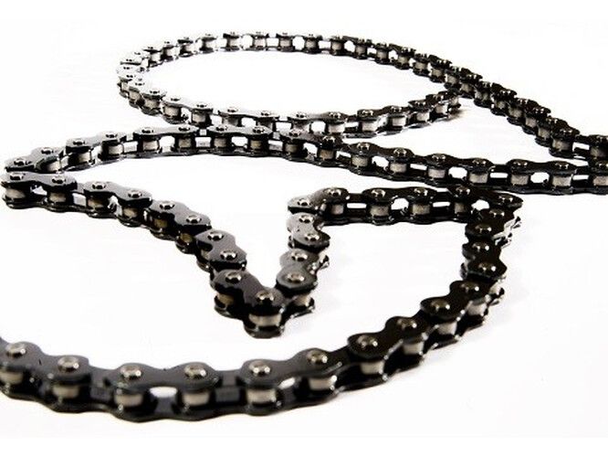

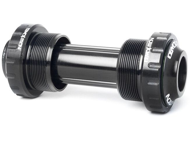

SS wäre auch cool, weil ich habe noch keins, und so ist dann eine Aufbau mit BMX-Kurbel und fette Kette (1/2"x1/8") die letzten Tage gewachsen. Euro-BB mit extra lange Distanzhülse (für 73mm), 28t Kettenblatt, schwarze Kette mit silberne Akzenten:
(Bilder von Parano Garage)
Etwas in dieser Richtung:
(Bild von Juan Pablo Morado BMX)
Ritzel (HG) hinten muss wahrscheinlich 14-18t sein, finde da nicht so viele Kandidaten (Halo?) für eine breite (1/2"x1/8") Kette, da hätte ich gerne Tips von euch (kein dünne Blech, muss fett sein).

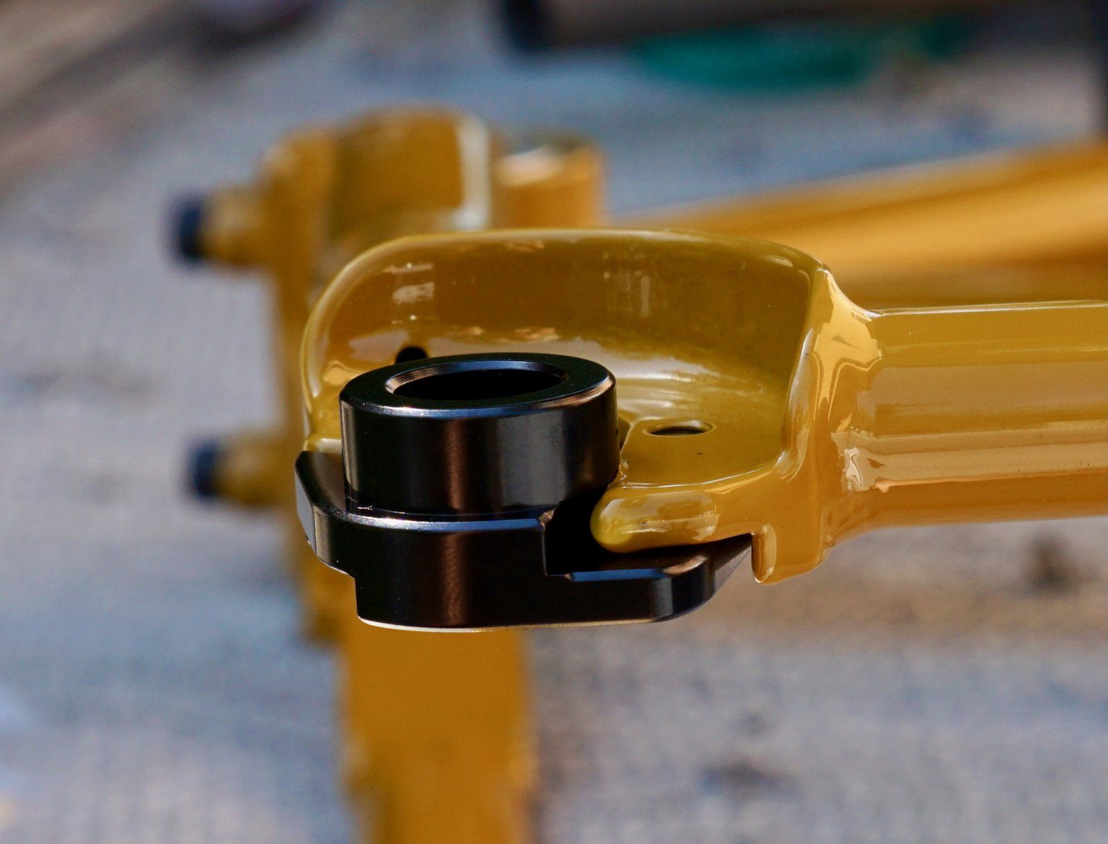

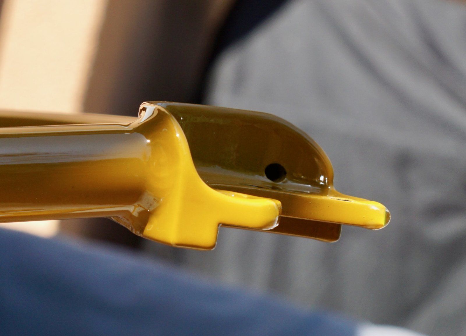

Heute werde ich den Rahmen vorbereiten, leider passt die Dropouts beide Seiten nicht ohne weiteres rein, an der Stelle ist Lack und Klarlack zu dick:
Ich will da ungern mit Gewalt reinknacken und Spannung auf das Teil verursachen...also, mit Pfeile das Lack runter machen? Hat jemand von euch das gleiche Problem gehabt?
Ja, aber bei einem anderen Rad 🤭
Bisschen anschleifen soll eh helfen, gegen Lackrisse.
