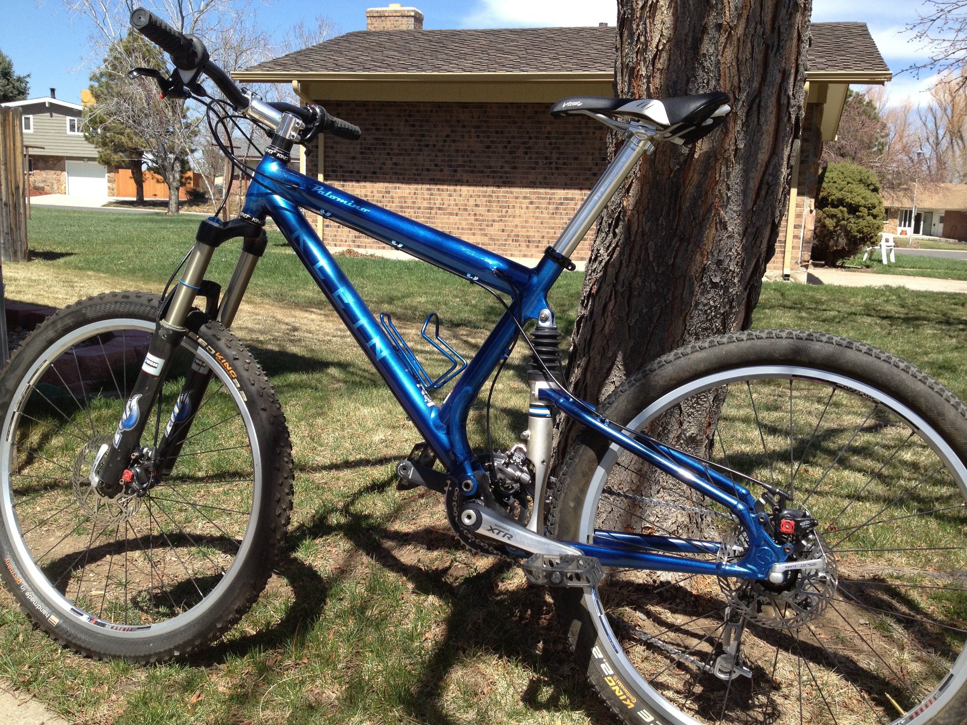

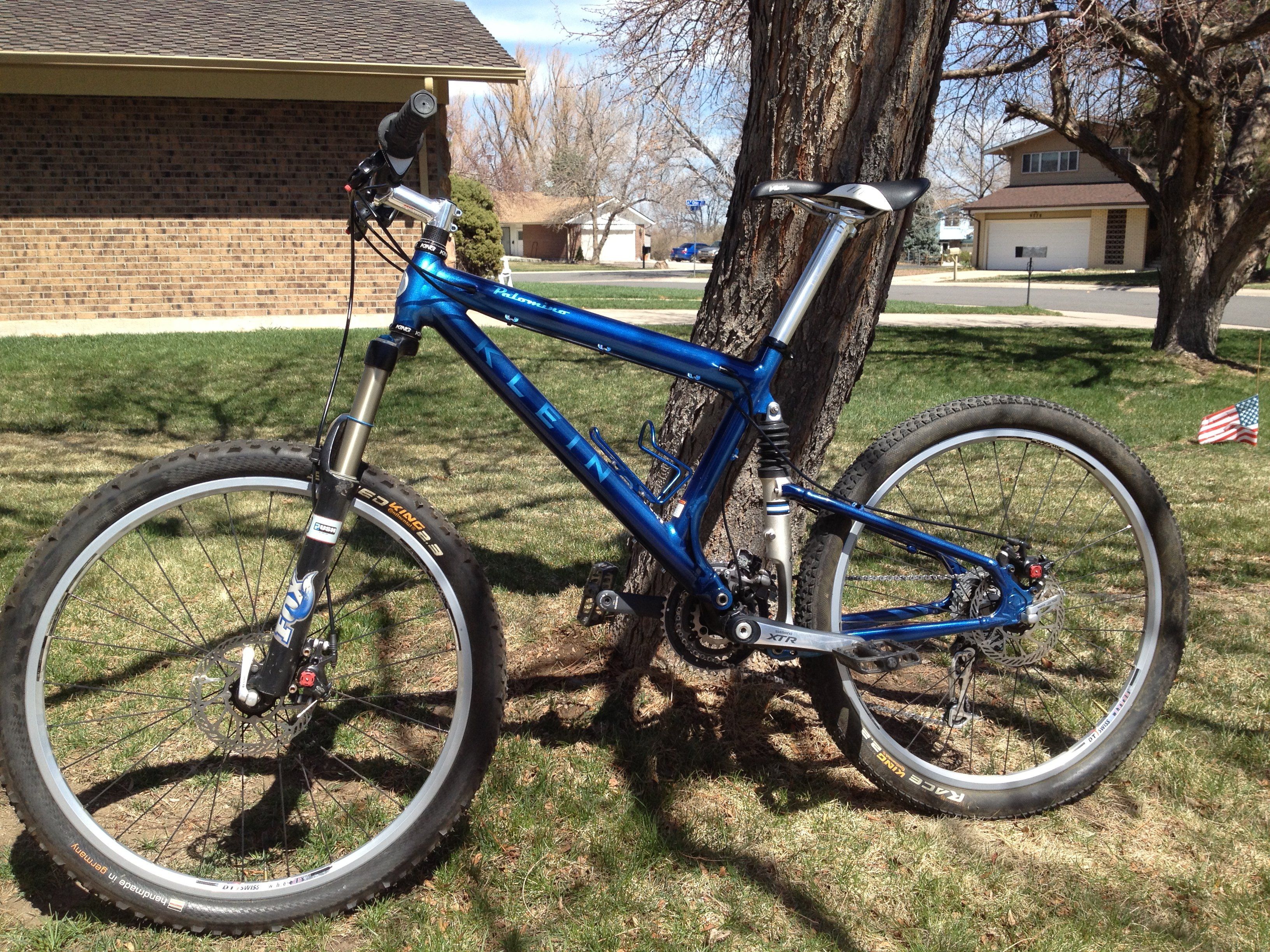

Wow, I looked up my invoice for my ML8 frame, date of purchase 6th of July 2015, which means I have been driving the same bike for nearly four years now!
How things have changed in four years time, it started out with a bizarre mix of components and it's now got a nearly full XTR drivetrain, a Reverb, DUC32 and a handmade wheelset.
