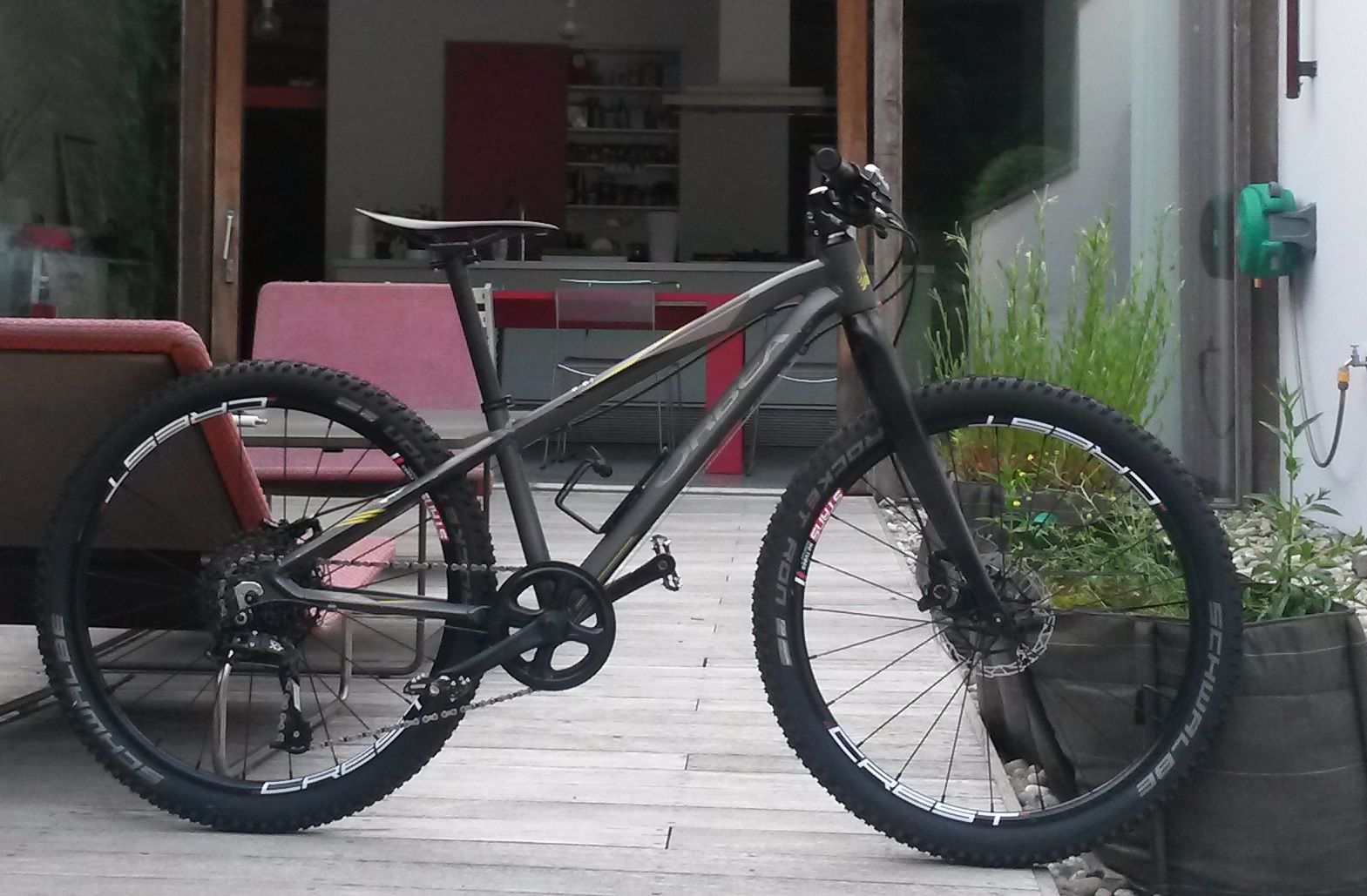

Here is the link to my post of presentation of the bike (well not yet finished at that time), and the wheels in particular (home build) :
https://www.mtb-news.de/forum/t/orbea-mx-24-team.817406/page-8#post-15241274
I understand your apprehension for Chinese "no name" carbone seatpost.
And I would think the same if it was for a 70-80kg rider. But for a 30-35kg kid, my opinion is that it's strong enough.

Directly with credit card on Aliexpress. They do no offer Paypal, but I think a similar system... I never investigated.
Yes, I've built the wheels... Indeed it does need some tools and skills.
But you could maybe order a similar setup from a wheelbuilder. In Germany, for instance, www.wheelproject.com
Thank you :)
Here is it completed :
But the saddle had been rapidly changed for the original Orbea. My son preferred that one, at least without padded bike shorts.

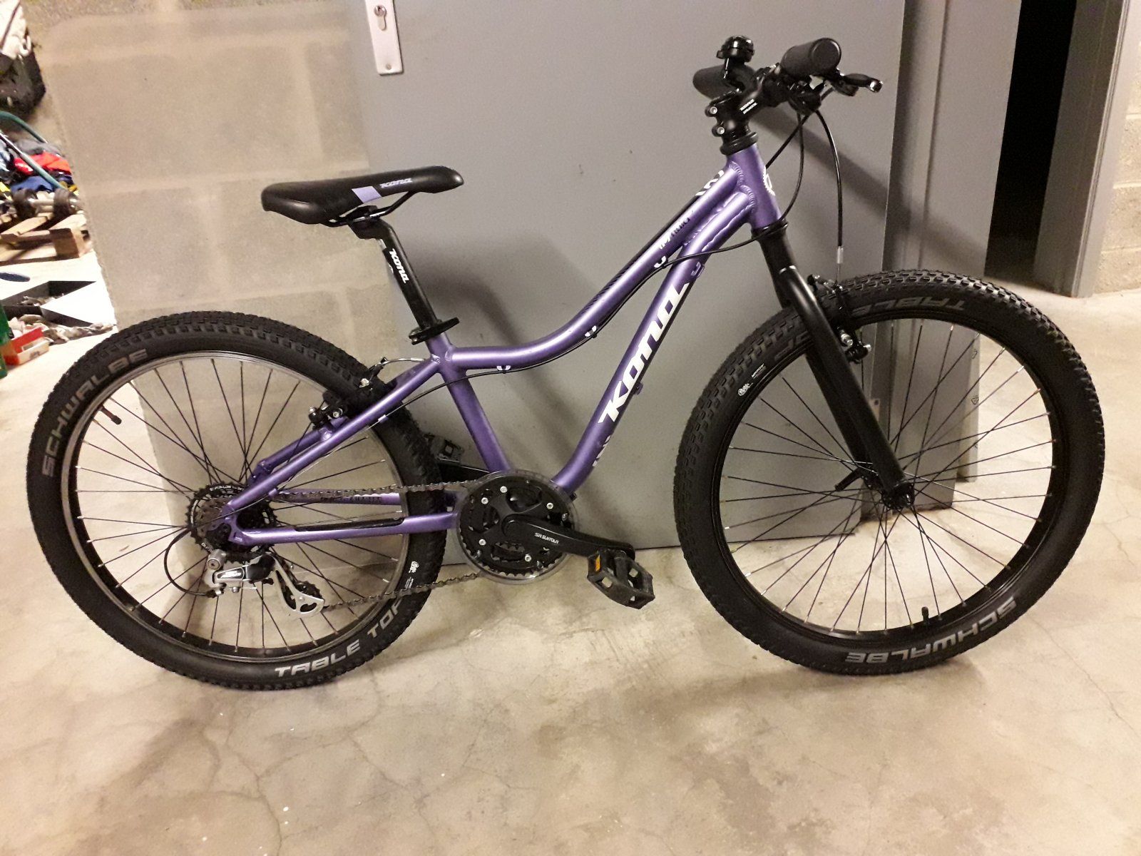

I think was makes nearly as much difference to the force required is good cable and hose, with lube.
I don't know, mine was not equipped with the same components, it's a 2016 model I think. It only had 7 speed, I don't know exactly what type of shifter it was (Shimano), but it was OK (and still is, now fitted to another bike that stays in our holiday apartment)
In fact, this bike has the wheels, transmission and (repainted) fork of the MX24 :)
You can see the original Kona 3x crank beeing now used as 1x... Waiting to be swapped for the Orbea crank :)

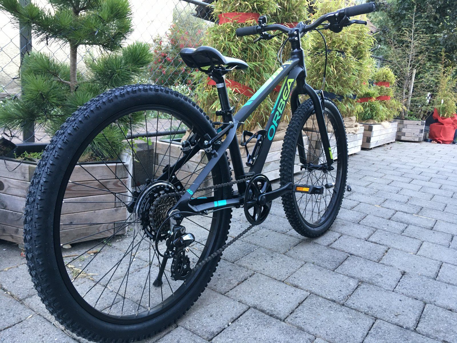

Hi Leute
Ist zwar nicht die Team Version, finde das neue Bike von meinem Sohn trotzdem der Knaller:
EDD49C05-CA56-4B36-AF0E-770C5FC32ED7.jpeg21298BF9-5EE1-447A-AB54-027C1E2EF4B2.jpeg55F15F7C-11CB-4D68-9261-5959853B094A.jpeg
Heute angekommen, aufgebaut und vom Sohn mit Begeisterung probegefahren... :)

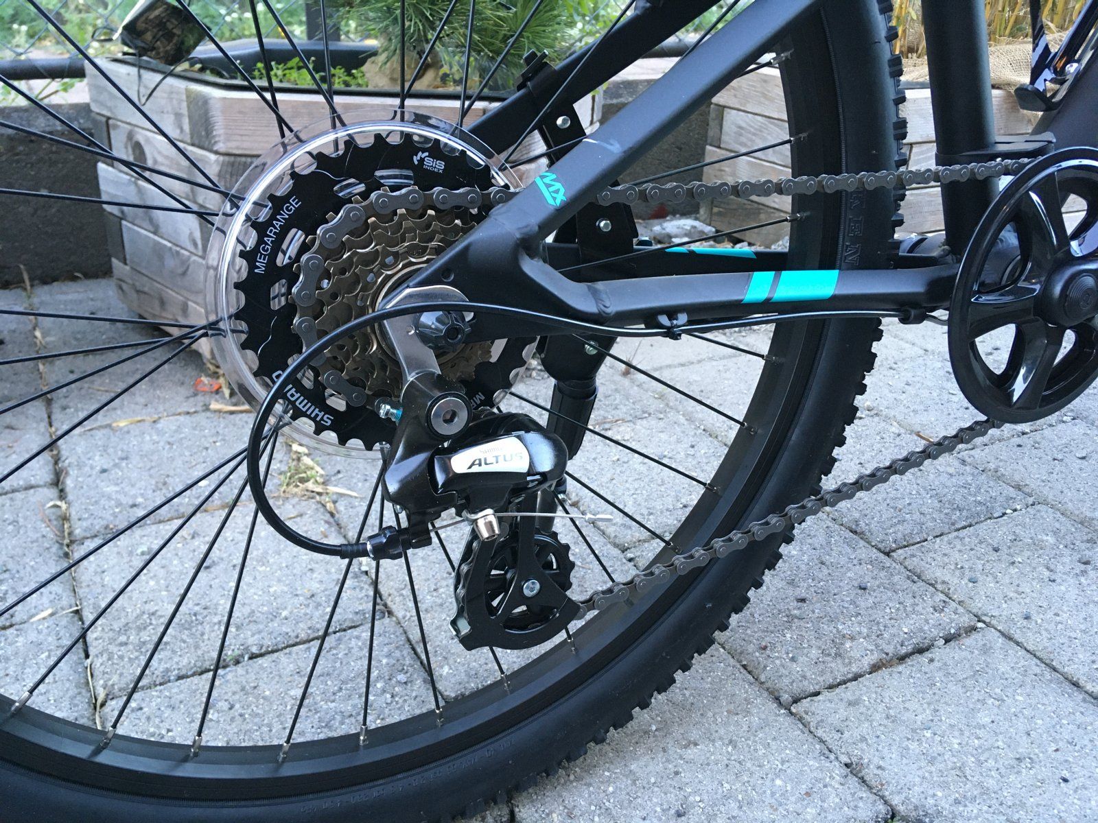

9-fach Kassette auf 11-fach Nabe (neuer Laufradsatz)
Dafür benötigt man einen 1,83mm Distanzring. Bei unserem Orbea ist Werksseitig eine HG200-9 Kassette verbaut. In diesem Fall ist es wichtig, dass der Distanzring drei Aussparungen für die Nieten des Spiders hat.
Kurbel(gehäuse)
68mm mit Shimano Hollowtech II. Darauf achten, dass drei 2,5x mm Distanzringe bei der neuen Kurbel beigelegt sind. Zwei für die Antriebsseite, eine für die linke Seite.

das mit dem distanzring habe ich noch nicht ganz verstanden, ist die original verbaute 9-fach kassette und nabe ein anderer standard als shimano?
bei mir passen bei standard shimano freilauf-naben (von welchem hersteller auch immer) eigentlich bisher alle kassetten von 9 bis 11 fach ohne distanzringe.
Dem Fahrrad habe ich einen neuen LRs spendiert. Der hat, so verstehe ich das, eine 11-fach Rennradnabe. Diese sind etwas länger als die 11-fach MTB Naben. Im Forum hatte ich dazu auch eine Zeichnung gefunden ...
Unterschied Shimano MTB zu Rennrad Freilauf
Oder auch hier beschrieben im Beitrag #7
