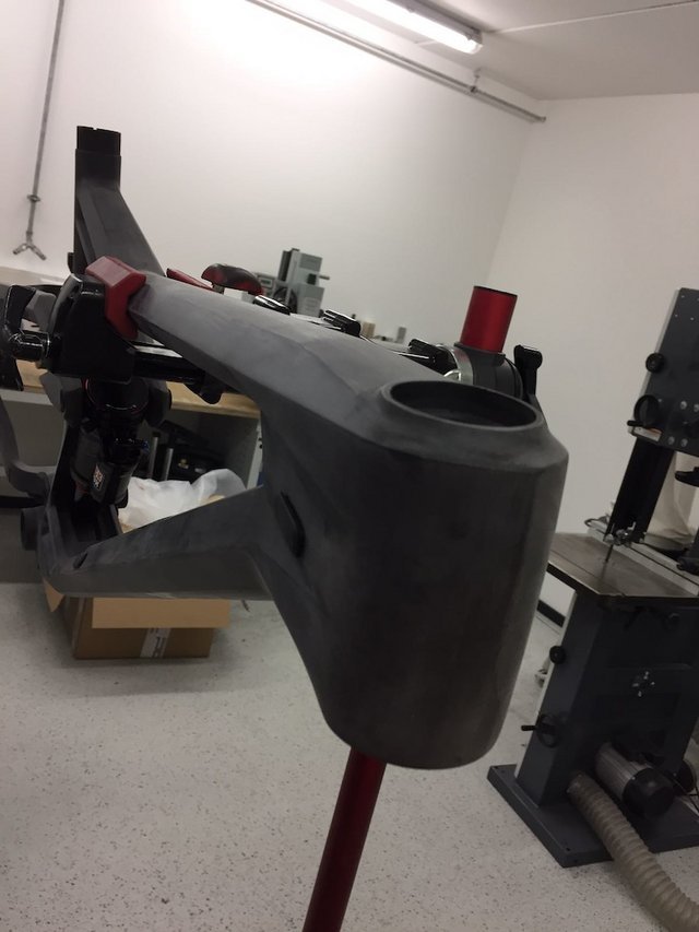

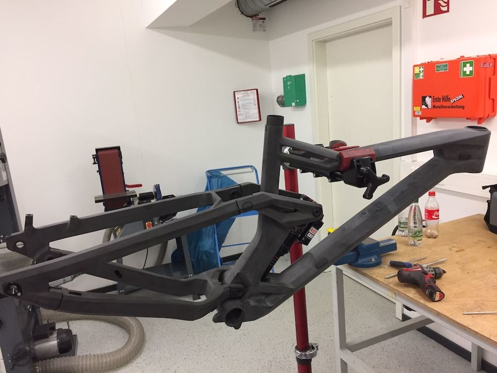

It looks like Radon are working on an updated version of their carbon Slide 160 - a few photos of the new frame shape were recently sent our way. Like its predecessor, the bike still uses a Horst Link suspension design, but the chainstay and seatstay pivots have been designed so that they appear flush with the frame, a look that brings to mind the appearance of the current Rocky Mountain Slayer. The top tube shape has also been altered - the way that the tube splits before joining the seat tube gives it a very unique look.
The Slide's rear shock is now affixed to the swingarm with a trunnion mount, usually a clear indicator that a metric sized damper is being used. There are rumored to be versions in the works for both 27.5" and 29" wheels, although final details have yet to be announced.

Bin mir nicht sicher ob mir dieser Stealth Look gefällt. Vor allem das Sitzrohr ist schon extrem massiv.
Nach wirklich viel Platz für eine Float X2 sieht es aus dem Blickwinkel auch nicht aus.
Vielleicht passt er ja in diese große Kammer
Rechts und links könnte schon ausreichend Luft sein. Ich hoffe es passt. Würde zu gerne den DB Inline oder Float X2 testen.
