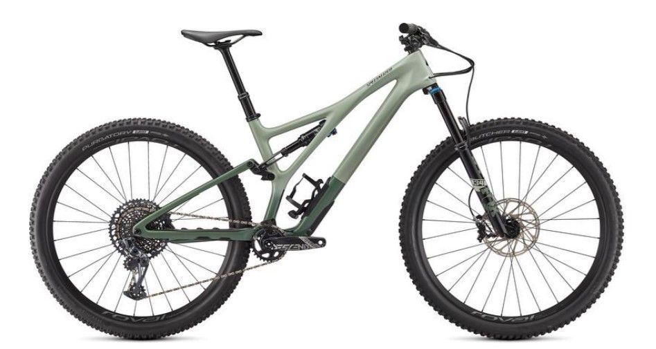

Es gibt News zum 2021 Modell! Der Link ist scheinbar schon wieder weg. Aber ich hatte die Sachen vorhin mal fix als PDF gedruckt -> unten im Anhang.
https://specialized.com.cn/products...1&_sid=f0b77a164&_ss=r&variant=32680233238591
Sieht auf den ersten Blick ähnlich aus, aber es scheinen sich viele Details geändert zu haben. Infos was die User dort so herausgefunden haben:
130mm of travel splitting the difference between the 120mm travel on the current Stumpjumper ST and the 140mm on the current regular Stumpjumper, similar to the LTD Downieville Stumpjumper.
Specs say it has an increased volume SWAT door and a 22 fl oz SWAT bladder. Between the bladder and a bottle in the cage you can now carry a solid 48 fl oz of water w/o a pack.
This build seems very trail focused. Fox 34, not a 36 or Lyrik and Fox DPS, not a DPX2 or a Super Deluxe.
2.889:1.000 leverage ratio based on 130mm travel and a 45mm stroke travel shock.
I got a head angle of around 66 or 65 degrees in powerpoint when I drew a line and made it parallel to the fork uppers & lowers.
S1 through S6 sizing. 6 sizes!
Short offset fork, steeper seat tube, slacker head tube, lower, longer, flip chip geo adjust.
Larger volume SWAT box.
Each frame size is tuned separately. Probably in the carbon layups and aluminum wall thickness.
Revised suspension taking into account what they learned from the Enduro. More anti squat for less pedal bob, better small bump and square edge hit performance.
Decreased frame weight.
Looks like the horst pivot is gone replaced by flex in the stays like on the Epic.
Sent from my Pixel 2 using Tapatalk
Just looked at the pics and from my quick view the bike is significantly longer and slacker even in the trail build. Purely speculation, but would guess 25-30 mm longer reach and at least -1* slacker. Most likely adjustable from 65.5>65. As others have mentioned the rear suspension is totally redesigned even if it doesn't look like it at first glance.
I spent about 5 minutes clicking back and forth from the Pemberton build current gen to the next Gen. With this build/design it looks like there is still room for an Evo setup at 140 or 150 travel and a 36 fork in the lineup. Figure 64.5>64 HA and a little more travel would give them a great lineup from EWS race bikes to AM to Trail/Enduro>Evo>SJ
It seems as if all the flex comes from the seat stays, with the chain stays and dropout area being pretty burly.This would make the new Stumpy essentially a linkage driven single pivot suspension system. The main pivot looks to be placed just a bit further back and on the exact same height as where the chain links to the front chainwheel. This should result in high anti squat throughout all gears and some rearward axle movement in the beginning of the stroke. The shock angle on the picture indicates there will be a good amount of progression as it moves through the travel. Other than that: shorter seat post, looooonger front end, slacker head angle. For me personally it's all I hoped for. Glad they didn't go with a mini version of the Enduro. No need for a complex separation of virtual pivot point 4-bar-suspension and short linkage driven shock on a 130mm trail bike. The cool thing with a simple design like this is, that the rider has a lot of possibilities to tune the suspension to his liking with shock setup or even a shock swap. Can't wait to see the aluminum version.

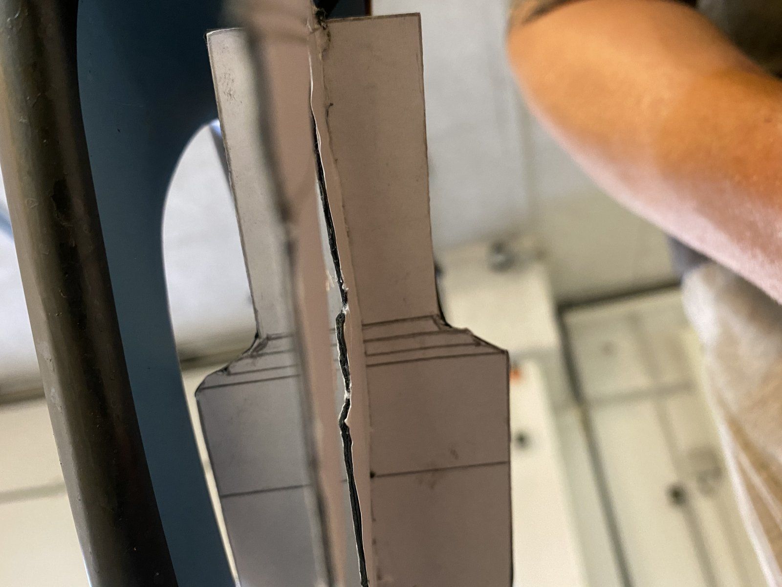

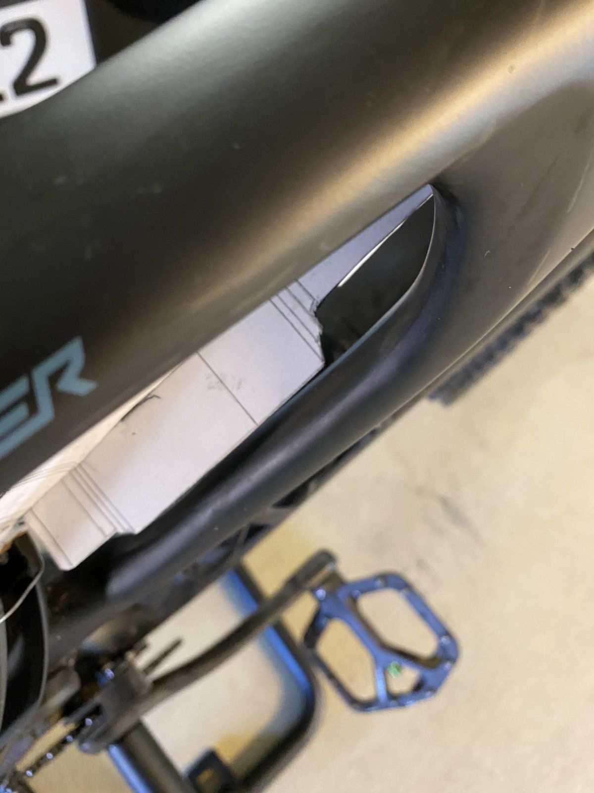

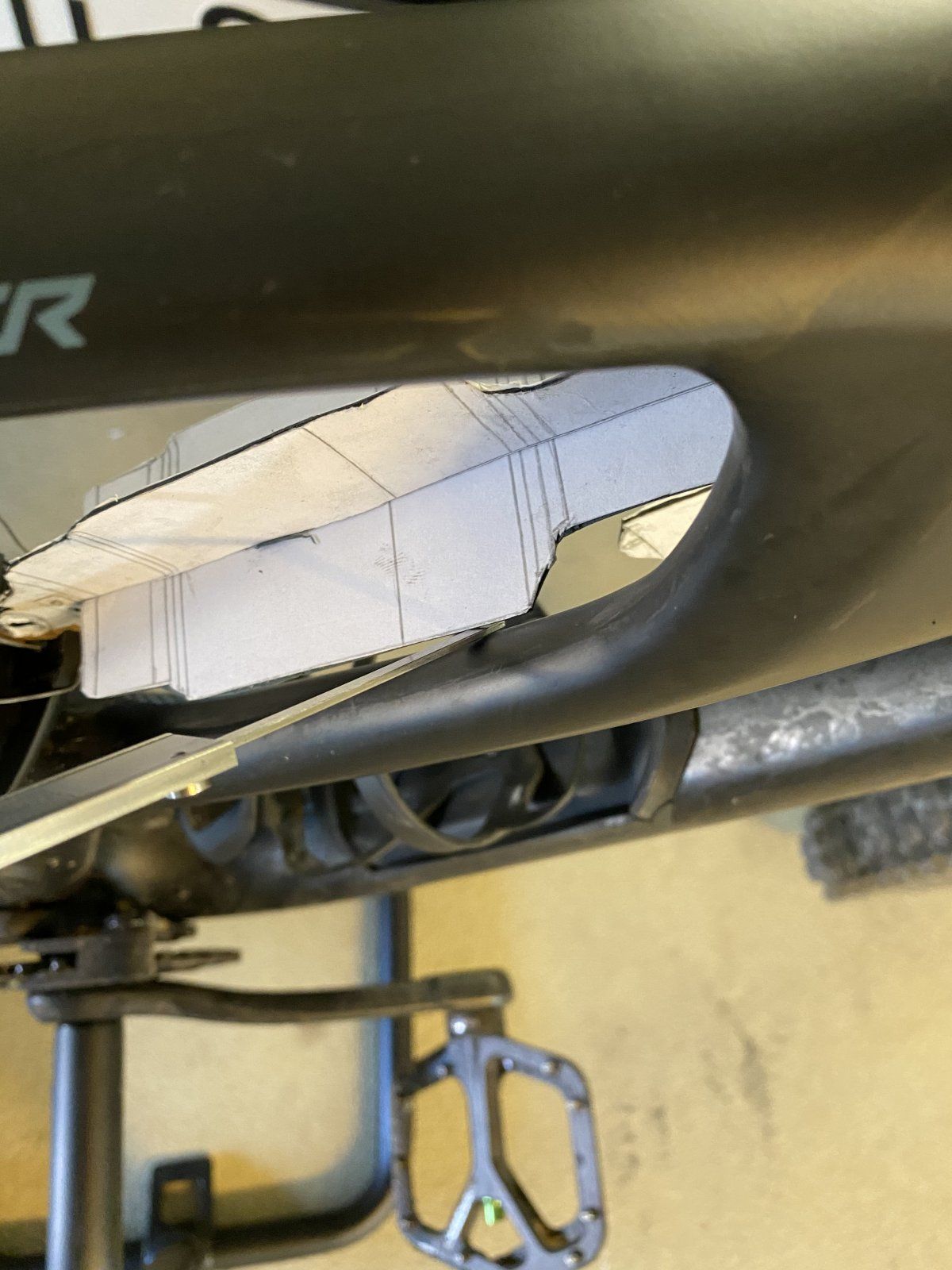

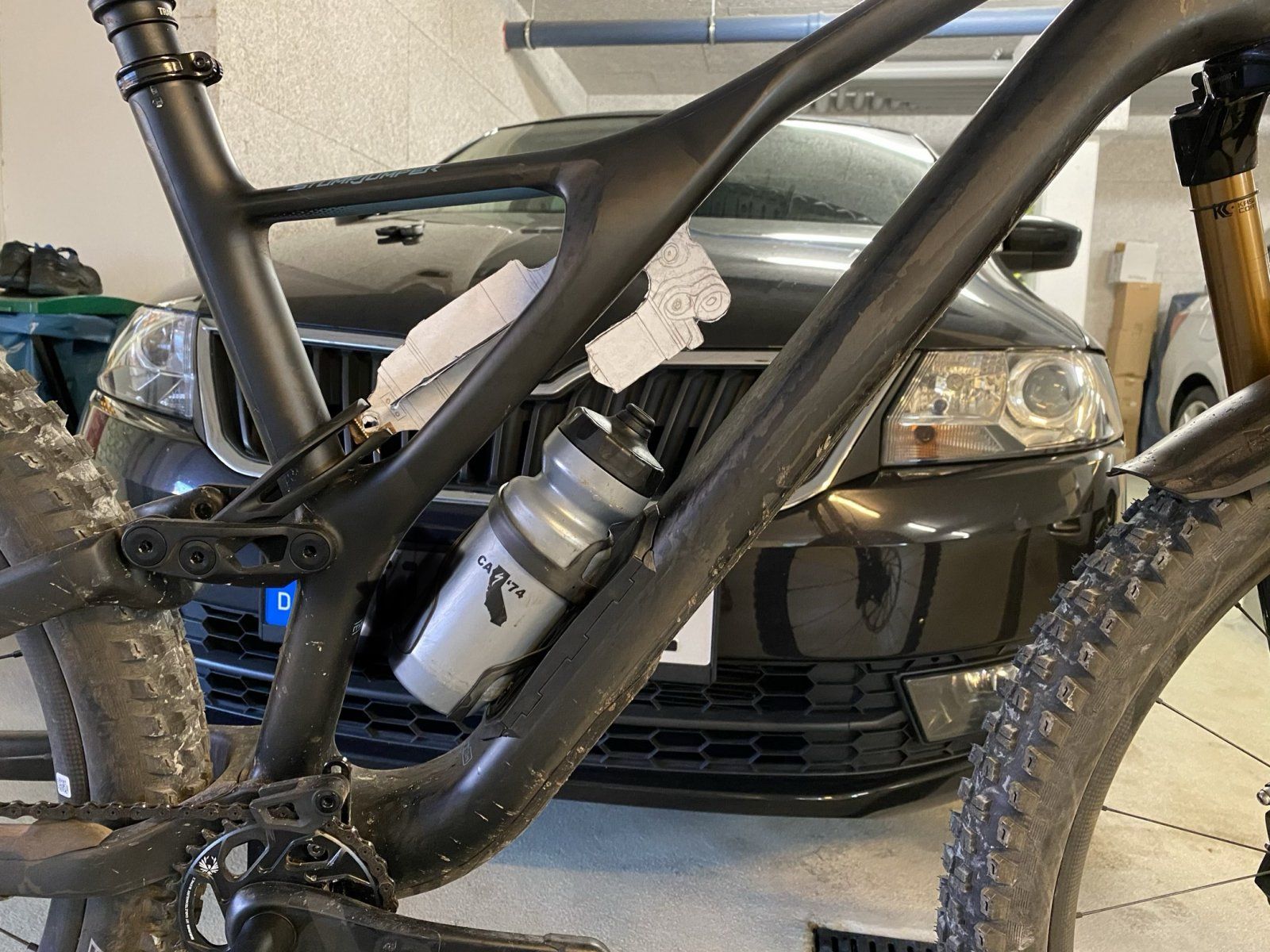

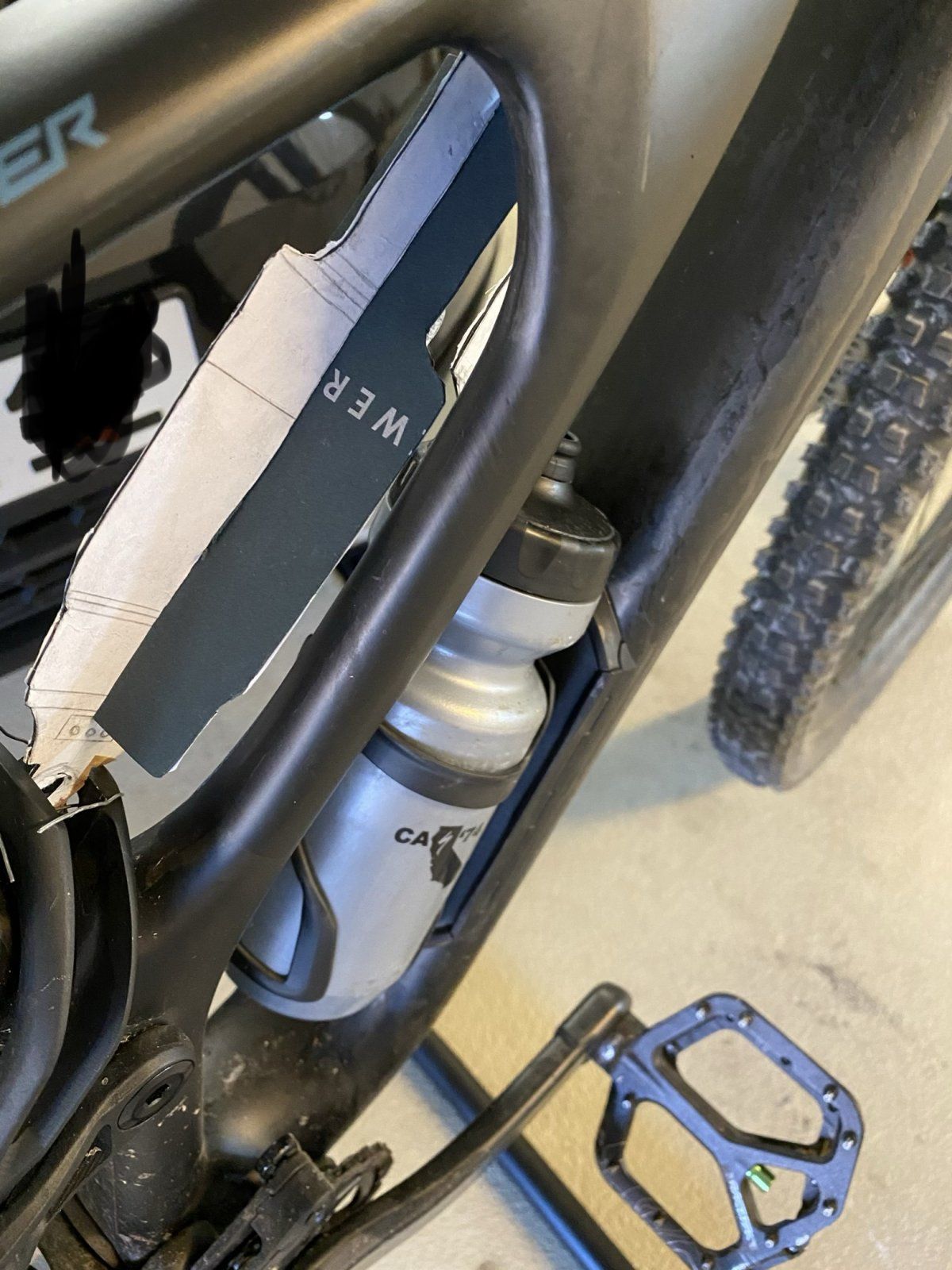

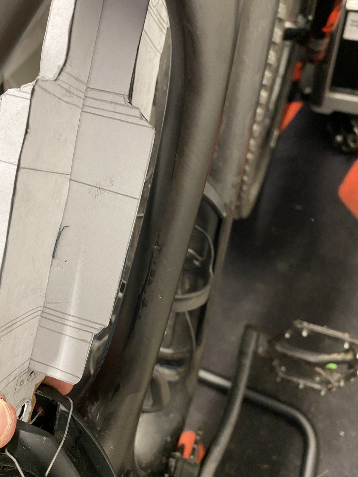

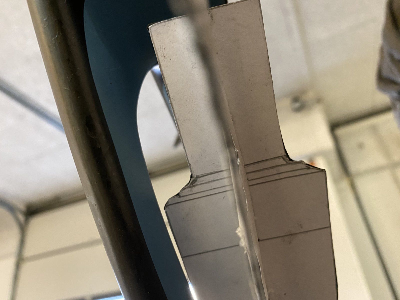

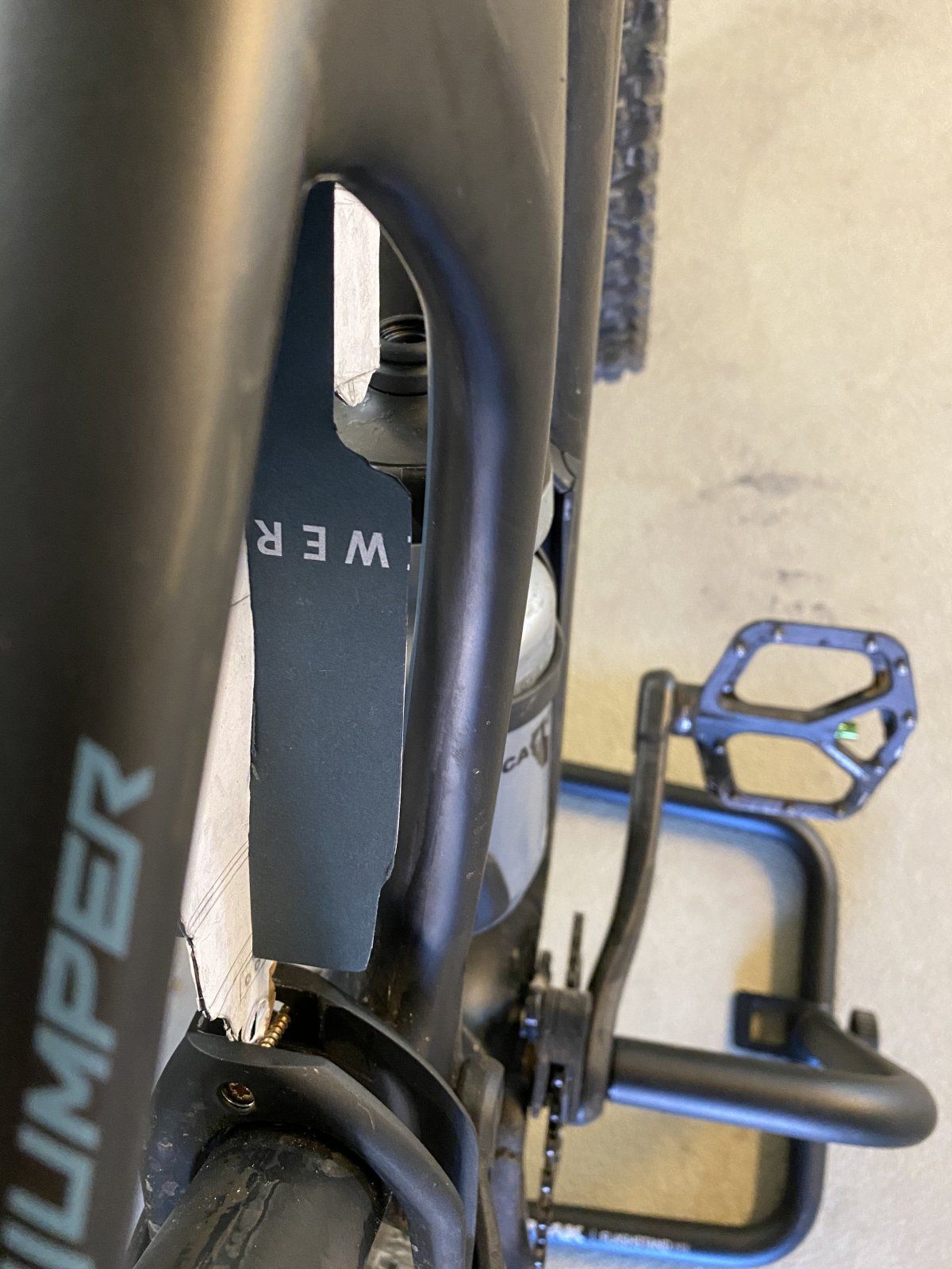

Was meint ihr, wird der passen?!
Die Maße habe ich genau von Fox genommen?!!!Ich befürchte die Querstrebe oder nicht?!!
