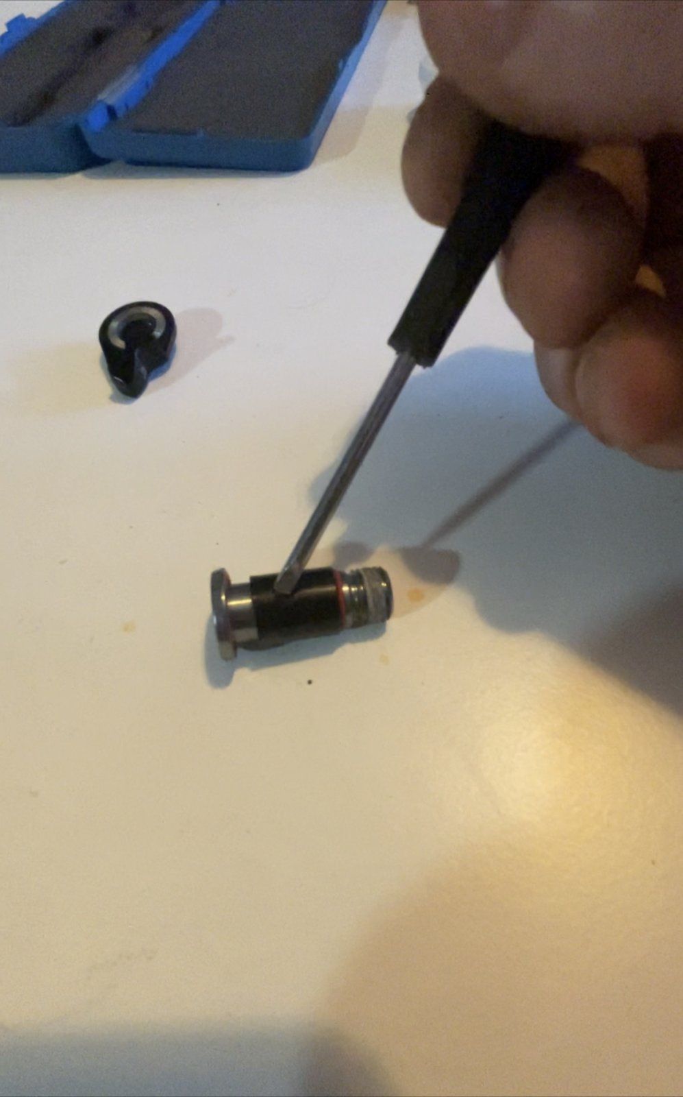

I have a green claymore frame for sale, with cranks, seatpost, headset etc... size L, change to a yeti s 160 ..... The changes to the axs for noise must shorten the cylinder to 14mm where they have the screw, no more noise !!!! The derailleur remains fujo, the noise is not due to the hit of the chain, but rather to the derailleur that moves and hits the pin.
yes, if you look in the comments, you will see that later he rode an axs and he did it!!!
I did it, I sanded a bit and now it is fixed !!! no more noise
