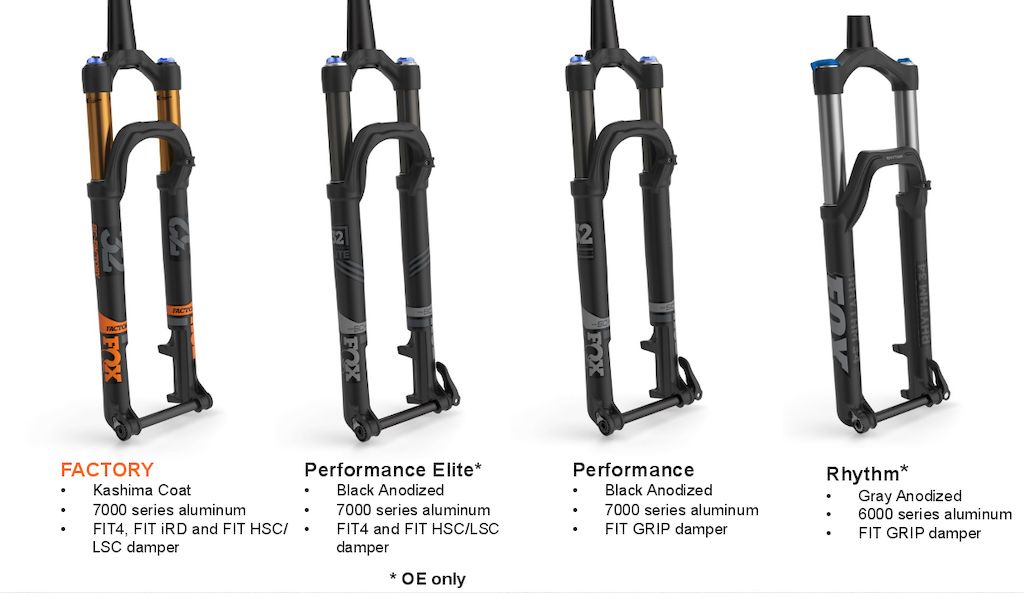

Die Abbildung ist Fox32 SC, die Beschreibung aber auch für die anderen Modelle. ;)
The Fox 34 is now available with Boost 110 axle spacing on both 27.5 and 29er wheel sizes, giving you the option of running it with Plus sized tires on the 29er version.
They also reconfigured the shim stack to make the low speed damping a little lighter for better sensitivity without changing the mid- and high-speed damping that controls mid-stroke support. The 36 also comes in Boost 110, also for 27.5 and 29, and it also gets the refined low speed damping tune.
