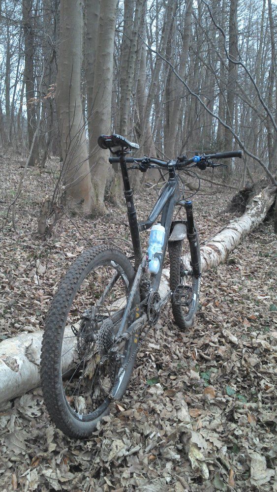

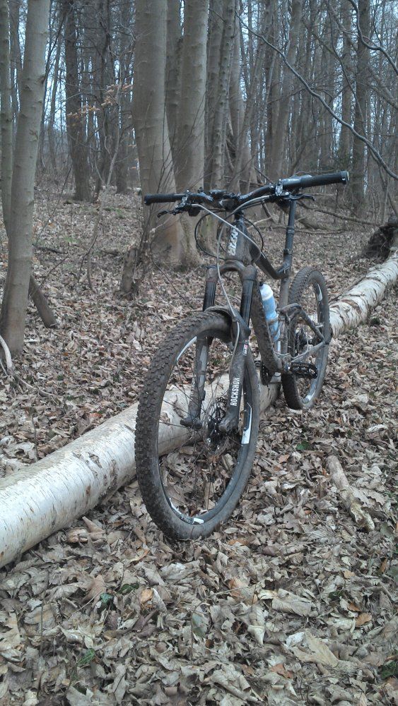

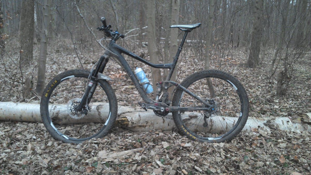

Mein Trance:

@xlacherx
RAHMEN: Giant Trance, AluxX SL, Gr.L
GABEL: Rock Shox Revelation RCT3, Solo Air, 150mm
DÄMPFER: Rock Shox Monarch RT3, DebonAir, 200x51mm
BREMSEN: Shimano XT 785, Shimano SMRT86 180mm
SCHALTHEBEL: SRAM X01, 11-fach
SCHALTWERK: SRAM XX1, 11-fach
KASSETTE: SRAM X01 XG-1195, 10-42
KETTE: KMC X11 SL DLC
KETTENFÜHRUNG: -
INNENLAGER: SRAM BB92, Pressfit GXP TEAM BSA
KURBEL: SRAM X01 GXP, Absolut Black 30T
PEDALEN: Chromag Scarab
NABEN: Hope Evo Pro2, VR 15mm/HR12-142
FELGEN: ZTR Arch EX / Sapim Race
VORDERREIFEN: Schwalbe Magic Mary Evolution, Trailstar, 27,5x2,35
HINTERREIFEN: Schwalbe Hans Dampf Evolution, Trailstar, 27.5x2.25
SCHLÄUCHE: tubeless
VORBAU: Syntace Megaforce2, 30mm
LENKER: Chromag OSX, 760mm
GRIFFE: Chromag Palmskin
STEUERSATZ: Cane Creek 10 / orig. FSA
STÜTZE: Rock Shox Reverb Stealth, 420mm, 125mm
SATTELKLEMME: Sixpack Skywalker
SATTEL: WTB Devo
GEWICHT: 12,87 kg (mit ungeeichter Kofferwaage ;))
