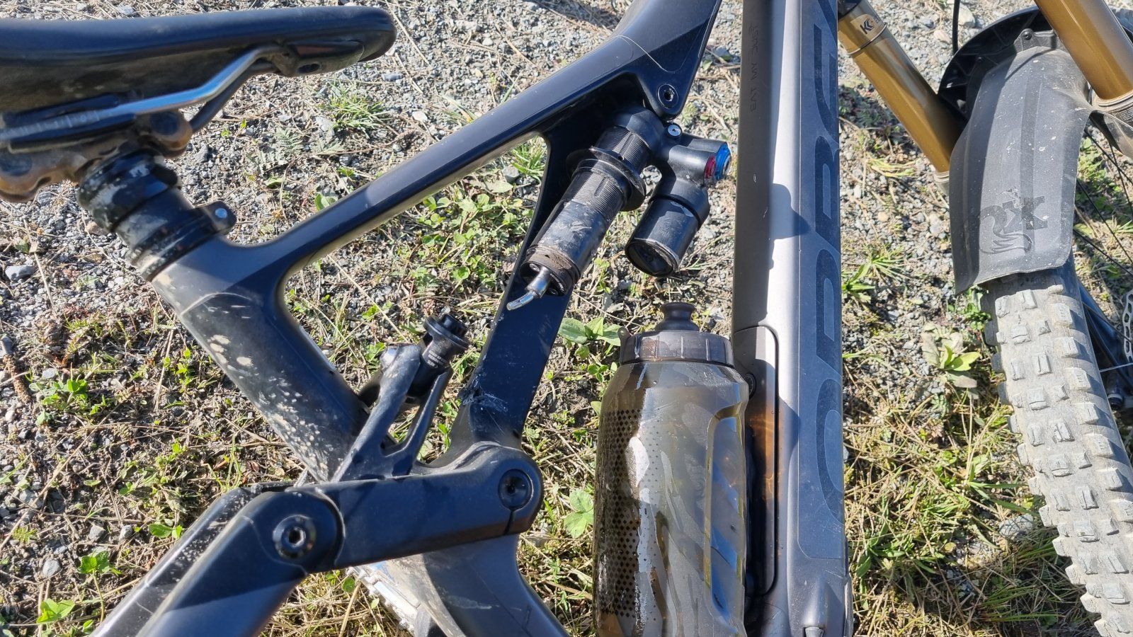

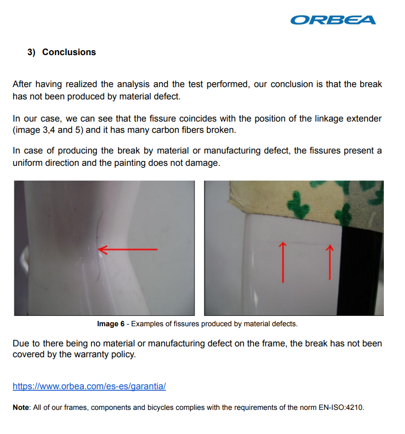

Fox DHX2 snapped in my Rallon. It's a well-known issue with bikes using this suspension system, something I unfortunately learned after the fact. Orbea in Rallon 2022-24 exceeded max allowed by fox strut length. Orbea rejected the warranty claim and refused to replace the damaged frame. I detailed the entire situation in another thread on reddit, including Orbea's full assessment and technical analysis.

Hello,

Anhang anzeigen 1909154Anhang anzeigen 1909158
Well known problem? It’s the first time I hear from that issue.

As I understood from the reddit thread, this happens in mullet setup only?

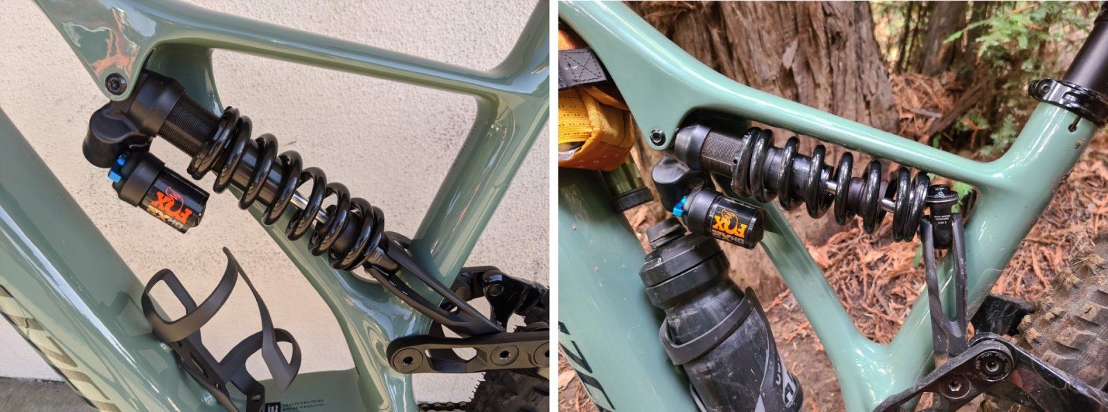

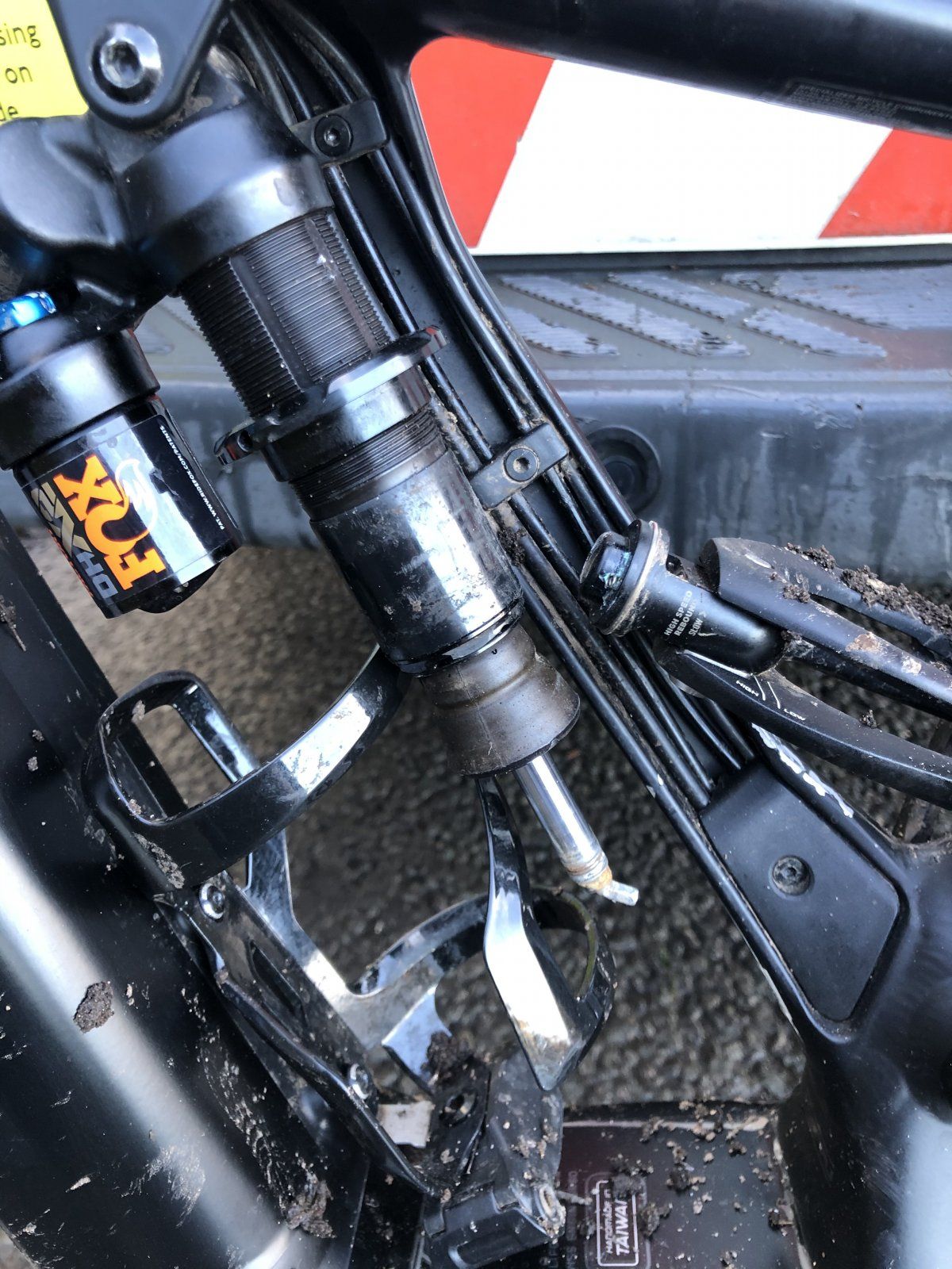

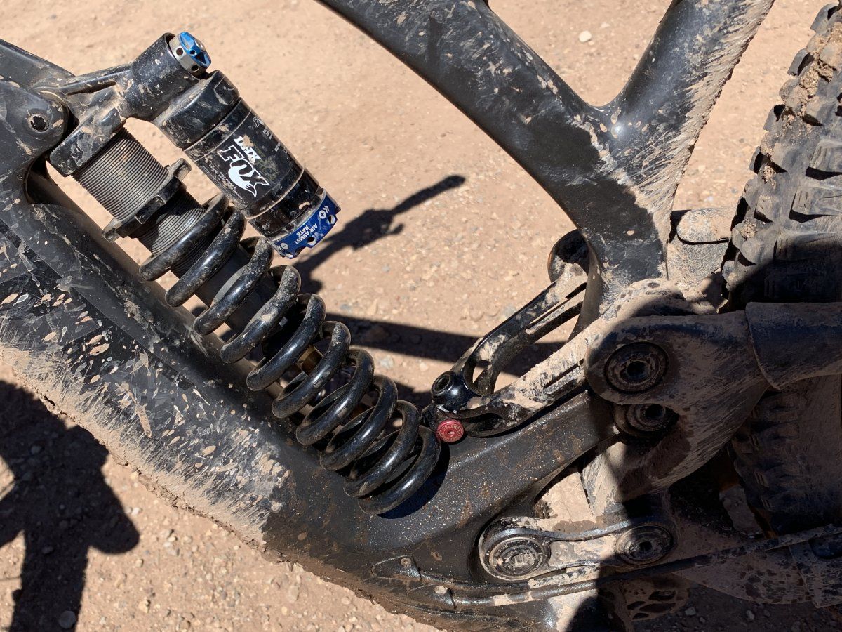

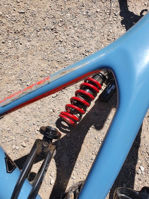

p.s.: the issue is well known on Specy Stumpy evo frames. Most of the photos you shared seem to be Species.
Specialized stumpy evo, Kenevo, Levo and cemmencal meta, it is the same suspension designee as Orbea rallon. With the same issues. And they can only be used with certain ones coil shock. Due to they can break it. Vorsprung made a long technical video about strut-mount, yoke suspension designee: Dear Bike Industry... Tuesday Tune Ep 34
