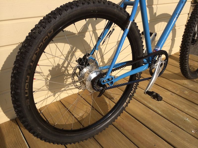

To be honest with you, I ever dismantle the hub...
I replace all bearings for sealed ones.
I have a titane custom OEM
I ride with an internal commande, with a disc Hub.
All screw as titane ones
I just install a Gates belt.
So, I was a mid specialist :)
Can you tell me where you order your cap ?
Like you, I don't want to be dependent about Rohloff for my hub.
I can't understand why the don't sold spare parts.
If I want to change the crank of my Porsche 911 GT3 (I have no Porsche...), Porsche sell me the spare parts, they don't mind if I can do it properly or not !!!
So, a little strike drive side resolve my problem... Maybe a pawl block or mechanism to much tightened

Thanks TunIN.

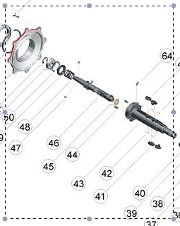

Hallo !
I write in English because I don't know German... I'm so sorry, and Google don't help me anymore :)
I ask to me why the spring in the end of the selection axle is so strong ?
I speak about the 48 parts.
Is someone can explain me in few single words the utility of such en strong spring ?
Thanks a lot !

Hallo !
Thanks a lot !
That spring is part of the indexing mechanism ... with 3 balls and a castellated washer.
The set of indexing allows the change step by step.
Hallo TunIn ;)
Yes I know that, but why do you think that is so much strong ?
It's pretty difficult to rotate the axle with an 8 mm wrench, no ?
