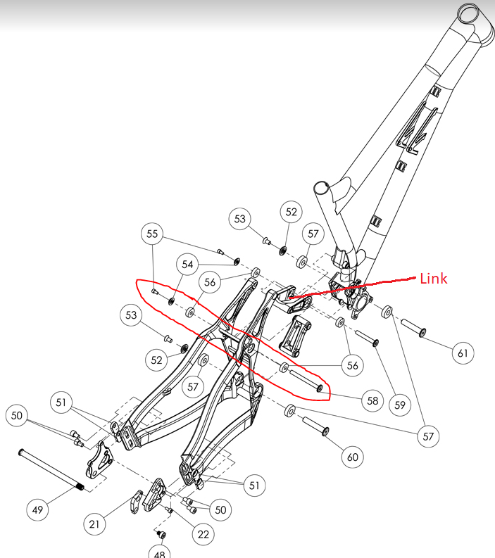

My friend has some creaking problem with his Rune. I found out that bolt 55, 58 are rotating together with bearings 56 while link didn't move. Bolt is tightened to 5 Nm (I tried also more torque but bolt is still rotating and there is creaking).
Is there anyone who had this problem and how this can be solved?

Creaking is normally a sign of missing grease, dirt or wear. Maybe you need to replace the bearings.
And that link also moves for me when I tighten it, I need to counter the screw on the other side.
Zwo weeks ago I had a discussion with two friends. Some bolts (phantom and rune) are rotating with the bearing and some are not. If one side of the bolt rotates with the bearing the other is not. Is that how it's supposed to be? Just curious....i don't get the mechanics behind that ggg
I have tried cleaning and regreasing but it is the same - I think bolt doesn't compress enough bearings to the link and then there is movement between inner race of bearing and link - they should move together. For tightening I also have to counter screw on the other side - but no matter how tight it is it rotates after - all other pivots doesn't rotate when tightened with correct torque.
Maybe you'll need to replace the bearing altogether.
I've also had an issue where one of the bearings of the link was only very loosely inside the cup, i.e. I could remove and insert it by hand instead of having to use a bearing puller / press. Because I was already in the process of replacing the frame under guarantee, Bernhard from everyday26 told me to send in the link and after looking at it he replaced it (although it probably was fine).
Maybe there's something similar for you, too, where the bearing isn't flush inside the link, and then there's some dirt which causes the creaks.
Thank you for help.
I disassembled everything and found out that almost all bearings were rusty (2 of them didn't rotate). I cleaned bearings as much as possible and put in new grease and assembled everything (it would be easier and better to replace bearings with new ones - next time). Now frame works without creaking.
