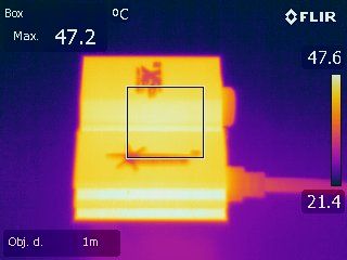

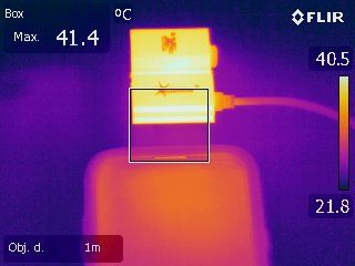

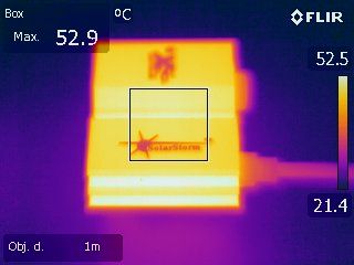

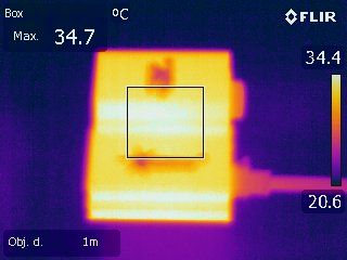

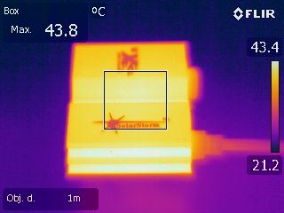

Thermal images with temperature
At work we have a FLIR T440bx Infrared Camera, so after applying the thermal grease to the LED slugs I decided to see the heat dissipation.
The test while not to scientific was 5 minutes on high with no fan and then 5 minutes on with a fan just to see how it handled. I wish I would have tested it before I applied the thermal grease to see the difference...
Image 1 at start of test 28.3Deg C
at 1 minute 34.7deg C
Finally 5... almost 6 minutes
at 1 minute with fan on, Used a small 12V fan about 3 feet away
at 2 minutes with fan on
Maintaining at 41.4Deg C after 12 minutes of On time, 5ish with no fan and 6ish with fan on
Hope this helps anyone
