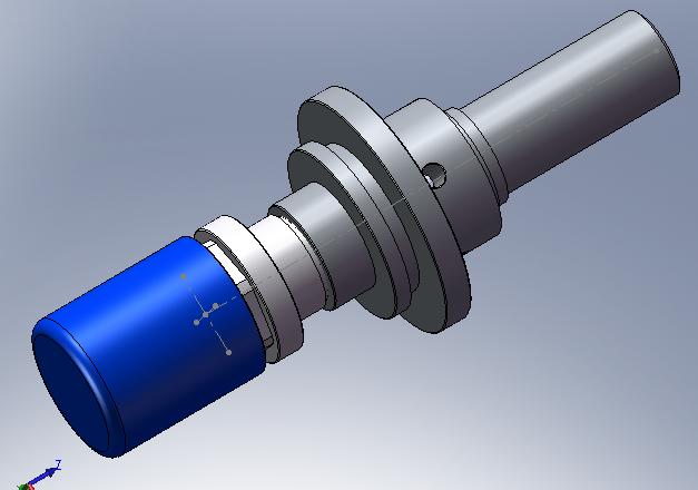

but i need a 40mm shorter version for my T8 with full 200mm travel(i cutted down my stanchions 40mm --> keeps the weight down). you can take this?
Compatible with 9 15 20mm axel road...
