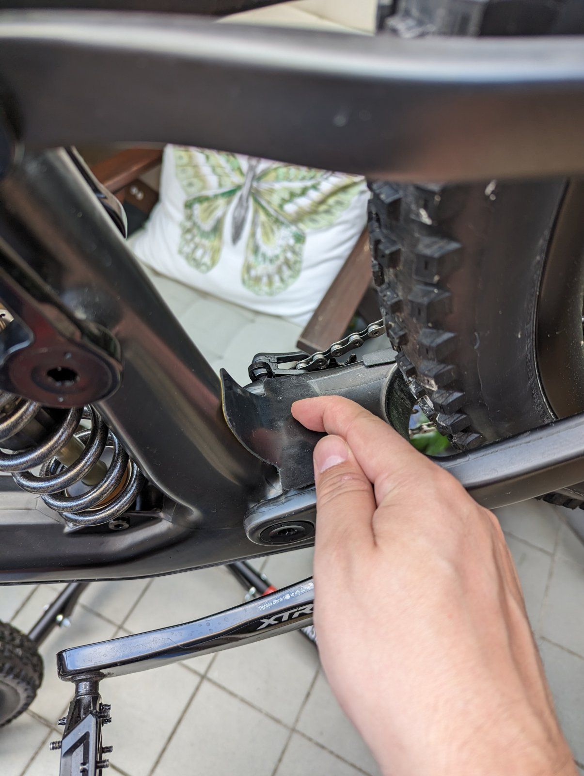

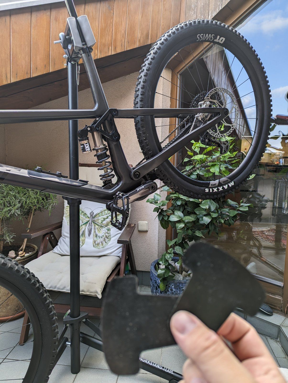

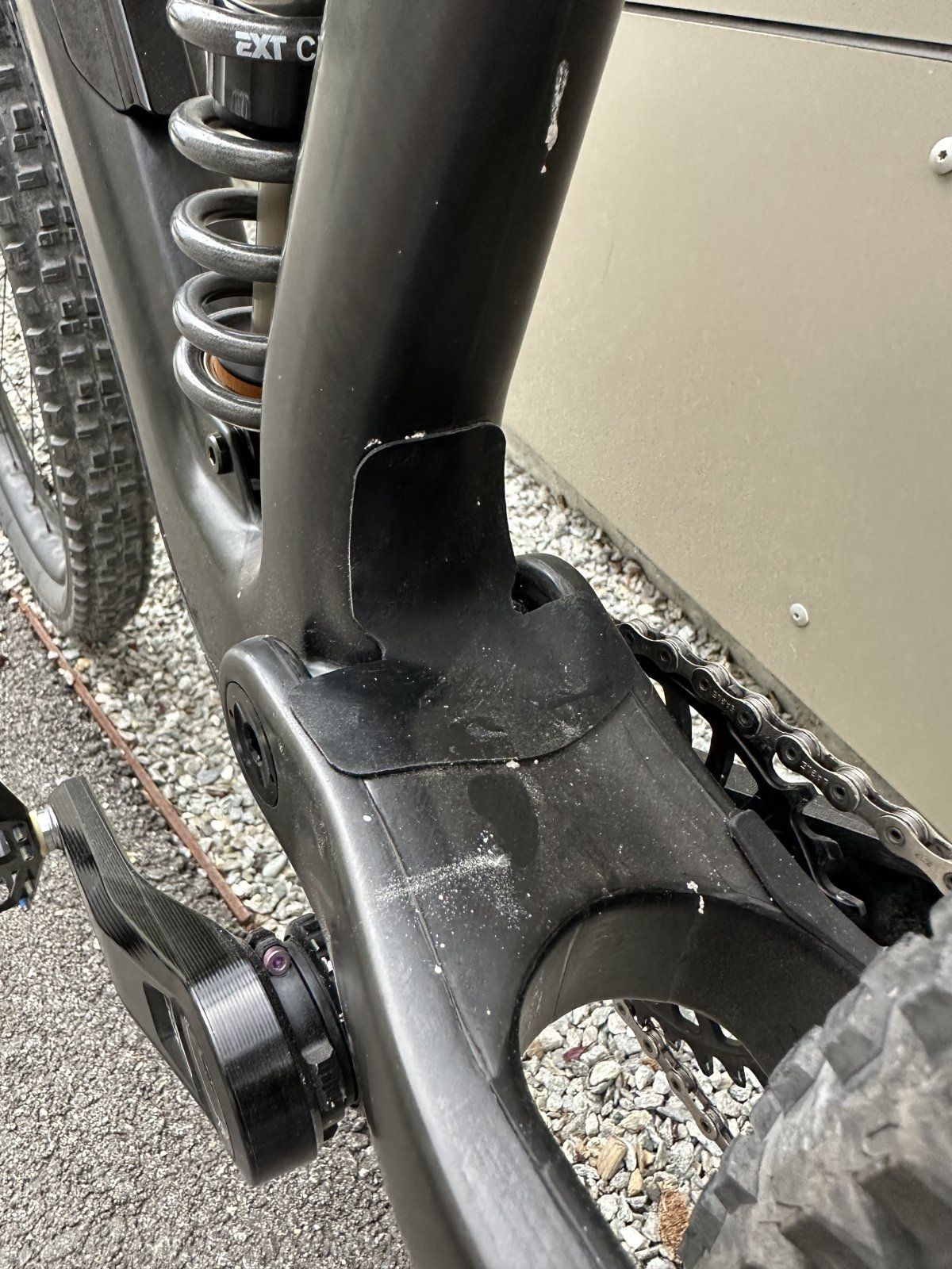

Guys, could someone please send a detailed photo of V2 Tarvo (Cinto etc) rear triangle mudguard? I got some from Last (bike came without it, shit happens) and trying to figure out how exactly to position it...
Exactly in that way you hold it at your second pic, that's how you have to stick it on the frame.

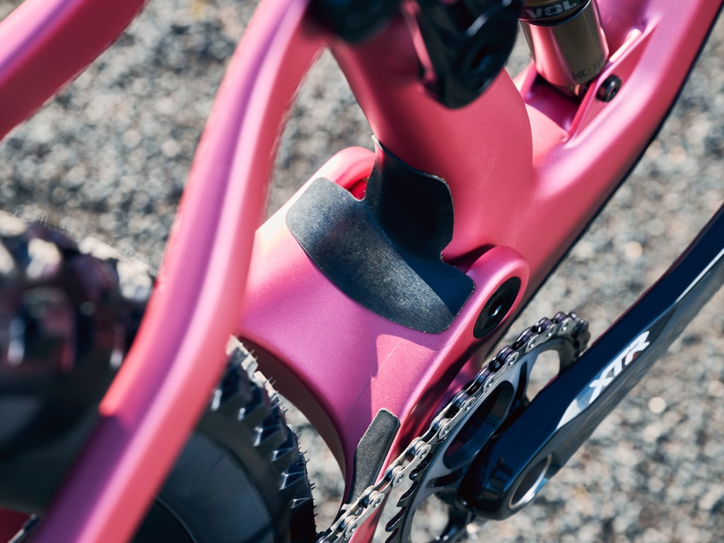

Position in pic two ...059 is right. This rubber shall prefent small stones from using the rear triangle as a nutcracker. See hp last (Tarvo) too. Or Cinto.. IT's independent from V1; V2
Doesn't look too elegant, I can already see the kilograms of swiss cow shit under it... (best case).
But better than a cracked frame and I have a spare one. Guess should push it more in between the front and rear triangles.

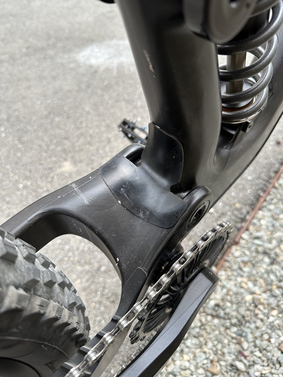

Position in pic two...059 is right. This rubber shall prefent small stones from using the rear triangle as a nutcracker. See hp last (Tarvo) too. Or Cinto.. IT's independent from V1; V2Anhang anzeigen 1707184Anhang anzeigen 1707187
Thanks, I saw the online photos, wanted to see how it looks in reality.
Looks like what Last sent me needs a bit more of a cut out in the corners for the bend.
I will see how it works, I guess I will have to modify and use the second one.
Thanks gentlemen!
It doesn't look as fancy as the frame, that's true. But it works fine. Mine was worn after 8 months of use. I will be getting a new one in the next few weeks when my other frame arrives.
Until then, I'll build another one myself.
Feel free to construct something better. :bier:
