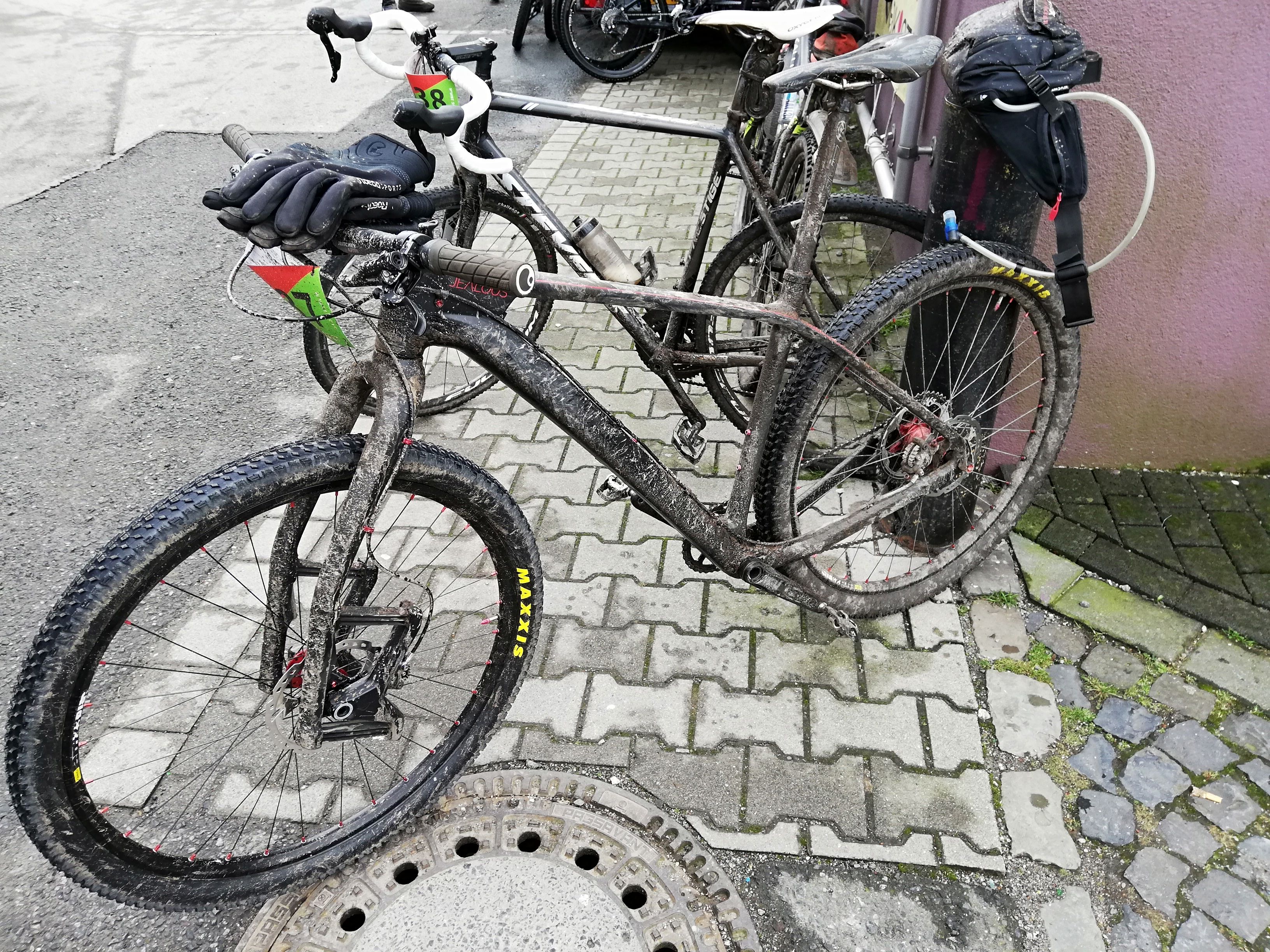

@diego1985 - very nice! :-)

@diego1985 - very nice! :)
