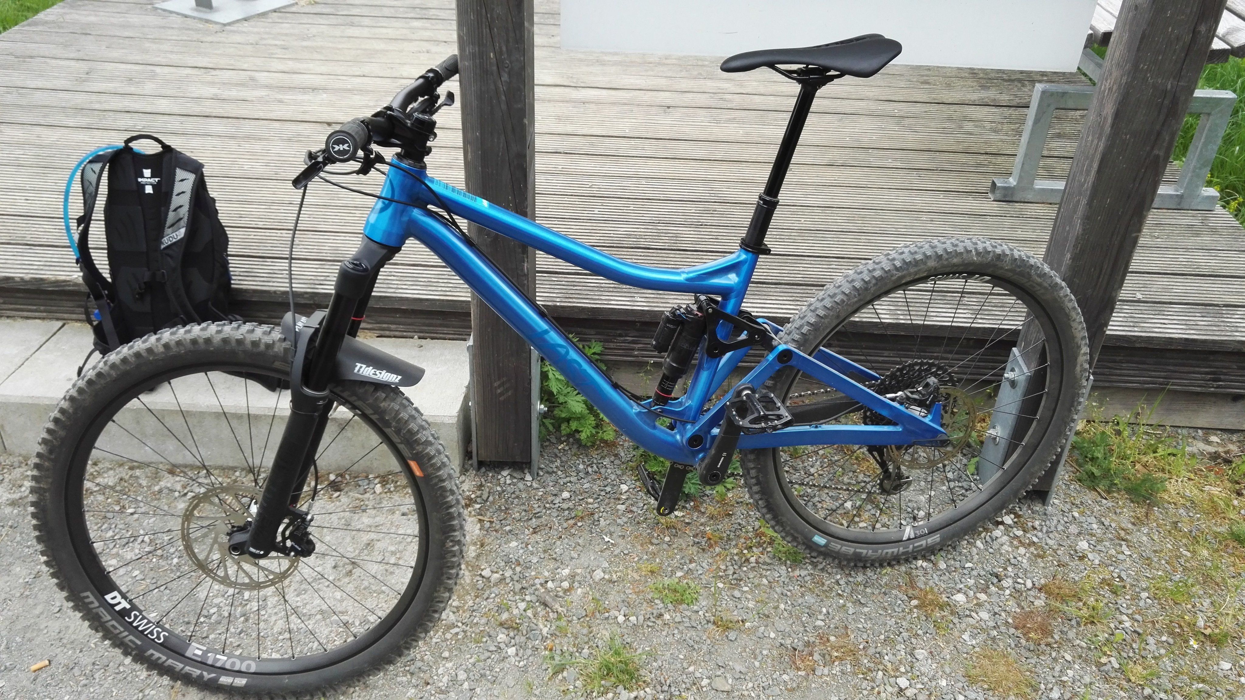

Which one will match the blue color of the frame more closely? Picking one is hard when you haven't seen the frame in real.
Also, while you guys are discussing chainring sizes - what is the largest chainring that can be mounted?
If you compare both pedals to a shot of the Clay in daylight, depending on where you look, both colors will match the frame.
I'd personally go for something contrasting the blue frame, if you choose to add an additional color to the bike. But I'm not a "tone in tone" guy, unless it's black ;)
Concerning the max chain ring size I can't help, but can tell you that the Taco for the bottom bracket sold by Last allows for a 32T max. Maybe some else knows better. Or you ask at Last directly.
Thank you for the reply and the photo! Real life photos are always helpful.
Actually i'm wondering just that - what color will match the blue frame. I'll use some Hope parts and i'm seeking inspiration, but I can't find any bikes with this kind of blue frame and colorful components.

I believe that matching colors will be difficult as the transparent blue of the frame produces a special effect that can not be matched with anodized blue parts. A contrasting color or simply black to underline the frame's effect might be the best choice. Just my two cents ;)
I chose black in black because these color questions would keep me up all night ;)
Oh dude, your last sentence is sooo right. For the last few days this is all I think about... day and night. :heul:
At first I wanted to take the black anodized frame and build it with DVO green, since i'm going to use DVO Topaz and Diamond (or MRP Ribbon... still can't decide). But on a second though - there are many black bikes, but this kind of blue is one of a kind and on top of that - blue is my favorite color.
I think purple will be my best bet with Hope's colors. This Pivot looks quite eye catching:
