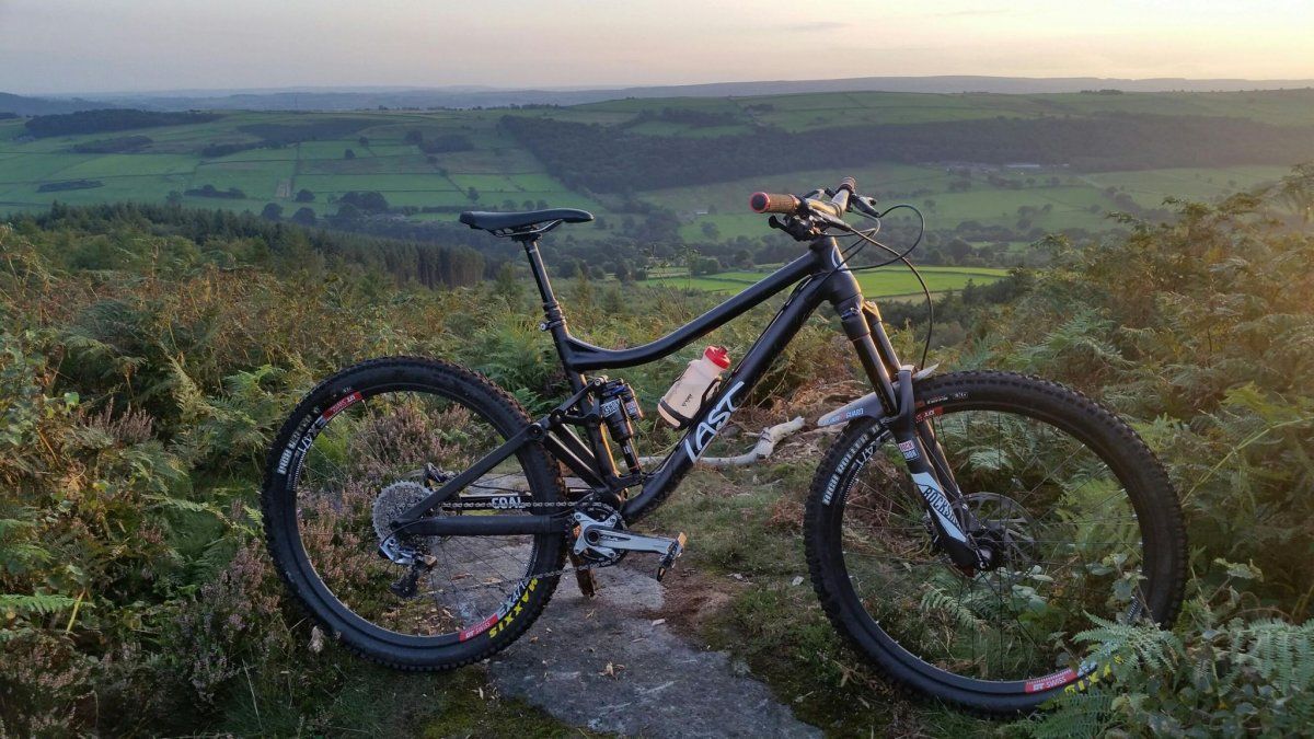

Hello friends,
Firstly apologies for my lack of German, I have been following these forums closely with the aid of Google translate to get tips for my Last Coal frame purchase. I have taken a lot of inspiration from Khujand's build so thanks to you.
I agonised over the frame size between M and L even changing my order from M to L half way though the waiting time! I am 175cm so usually between the two. After many hours of deliberation and many changes of mind, I took the risk to go for a large with a 40mm stem and very happy that I did. I have always ridden a medium frame, my previous frame being a Stumpjumper Evo (415mm reach with a 60mm stem). I wanted to run a 40mm stem so if I opted for a M Coal the overall reach (including stem) would have been shorter than the Stumpjumper (470mm vs 475). The Stumpjumer always felt too short so I definitely didn't want to go shorter! The L for me is great, I do not notice any loss of agility and at high speed it flies, so much confidence in the rough terrain! I am close to the limit for a 150mm Reverb, but happy to have this much drop.
My build is not the lightest, but I want it handle holiday's to the Alps as well as the downhill tracks here in the UK, the bike is used for Enduro racing.
My build:-
  • Last Coal Frame L (ordered without shock)
  • Monarch Plus RC3 DebonAir 2016 216x63 (ordered from my friends at TF Tuned with Last recommended tune)
  • RockShox Pike RCT3 Solo Air Forks - Boost 2016
  • DT Swiss EX471 on Hope Pro4 Boost Hubs
  • High Roller II 2.4 Front and Rear (setup tubeless)
  • Specialized Zee II Bottle Cage
  • RockShox Reverb B1 150mm
  • SLX 175mm crankset (from and old bike)
  • OneUp 32t Narrow Wide chainring
  • OneUp Bash Guide
  • SRAM XX1 Cassette (from and old bike)
  • SRAM XX1 Derailleur (from and old bike)
  • SRAM GX Shifter
  • SRAM Guide RS Brakes
  • Enduro Guard mudguard (essential in UK!)
  • Renthal Spex Stem 40mm
  • Renthal Fatbar Carbon bars 780mm
  • Lizard Skins Peaty Grips (the best!)
  • Hope Bottom Bracket
  • Hope Headset
  • Hope Seatpost clamp
  • Fizik Monte Saddle (low profile so I can run 150mm Reverb)
  • Crank Brothers Mallet E pedals
I do not know the total weight but I don't care. The bike is solid, super stiff and the suspension is the best I've ridden.
Sorry for the brake cables, they still need to be shortened. I will also replace the drivetrain with SRAM X01 Eagle 12 speed after the UK winter. I hope you like it.

Nice one. Have fun with your Coal and greetings to the UK
Karsten
Ein Marzocchi Roco TST Coil passt auch in's Coal :)
