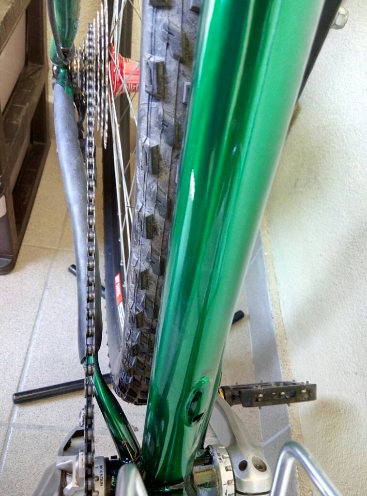

Hello guys, sorry for the English, jsut wanted to share here that the frames will fit a 32T on a older 49mm chainline cranks.
I have currently some 2.5-2mm space between the chainring and the chainstay.
Maybe this will be helpful to someone.
Thr chainline is center on the 6th cog.
So theoretically it will fit a 34T on a crankset with 53mm chainline like the shimano xt/slc boost.
And here's the obligatory photo of the build.
Cheers,
Drakche
