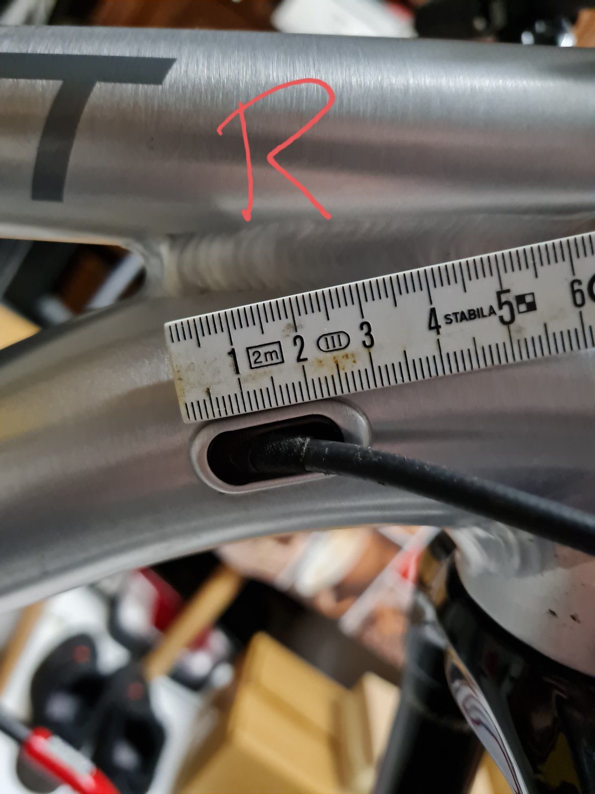

Don't find any pic that fast, but it's possible to have break routing on the same side.
I'll be using AXS gears so rear brake will go on the Right side, dropper will go on Left side. Not what I intended as when I placed order I thought I could put 2 cables either side. Bit of a design fail by @last-bikes.com really, as it not going to look nice. Had I known this before placing order I probably wouldn't have bothered, it's taken the edge off the excitement of new frame now
Will have to put up with it until I can get an AXS dropper, they are not available until 2022 😞
If you leave the little metal guide at the cable entrance off there should fit 2 cables. just have to use a zipp tie or something like that to keep them from rattling. but i havent tested it myself.

Looking at post a while back, not sure there is room for 2 cables.
Is the internal routing the same size left and right and just the exit smaller?
I looked for a post a while ago and am not sure if there is room for 2 cables.
Is the internal guidance left and right the same size and only the exit smaller?
screenshot_20210628_150113_com-android-gallery3d-jpg.1299724
Why not talking to Last Bikes about this issue 🤷‍♂️
Maybe they already have a solution...
I did....................
the right size has only space for one cable. The 2 whole insert only fits on the left side.

As I said a bit of a design fail/fault
OK, that's a bummer 😤 From your point of view, this might be a design fault, but for the mayority of Last Customer not 😉
But I'm sure, there is a solution for that. Be creative!

Just ask them to send two inserts for left side? Or take the one for left side for right side (did you order raw? open up the hole in the frame a bit...) or print something?
Deswegen die Frage ob raw.
Da hätte ich ich kein Problem damit rechts "aufzumachen". Dann da das linke insert rein und für links eins mit nur einem Durchgang drucken

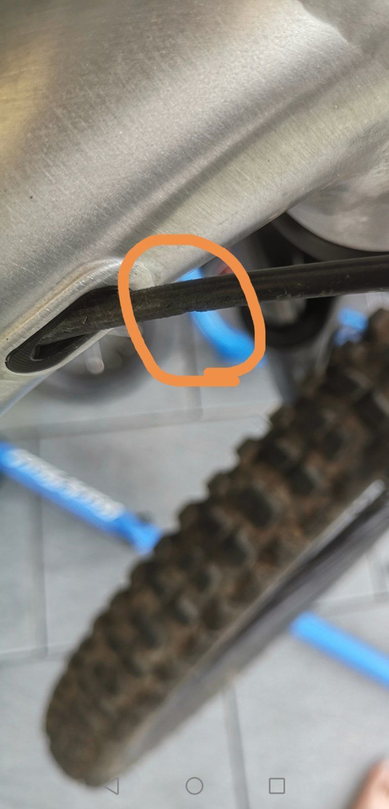

Auf keinen Fall in den Rahmen bohren...:eek:
Die Löcher haben doch ne Aufkantung bzw. Verstärkung, die hättest du bei einer Erweiterung nicht.
Das wird dir LAST niemals erlauben.
Jetzt wo du es erwähnt hast, rate ich doch besser davon ab!
Hatte mal ein Canyon Spectral, bei dem diese Abkantung am Ausgang für die Dropper gefehlt hat.
Da haben sich dann Risse gebildet. Wurde zwar getauscht der Rahmen, aber war dann beim neuen Rahmen wieder ohne Abkantung. Somit war das Thema Canyon dann damals beendet für mich 😉
