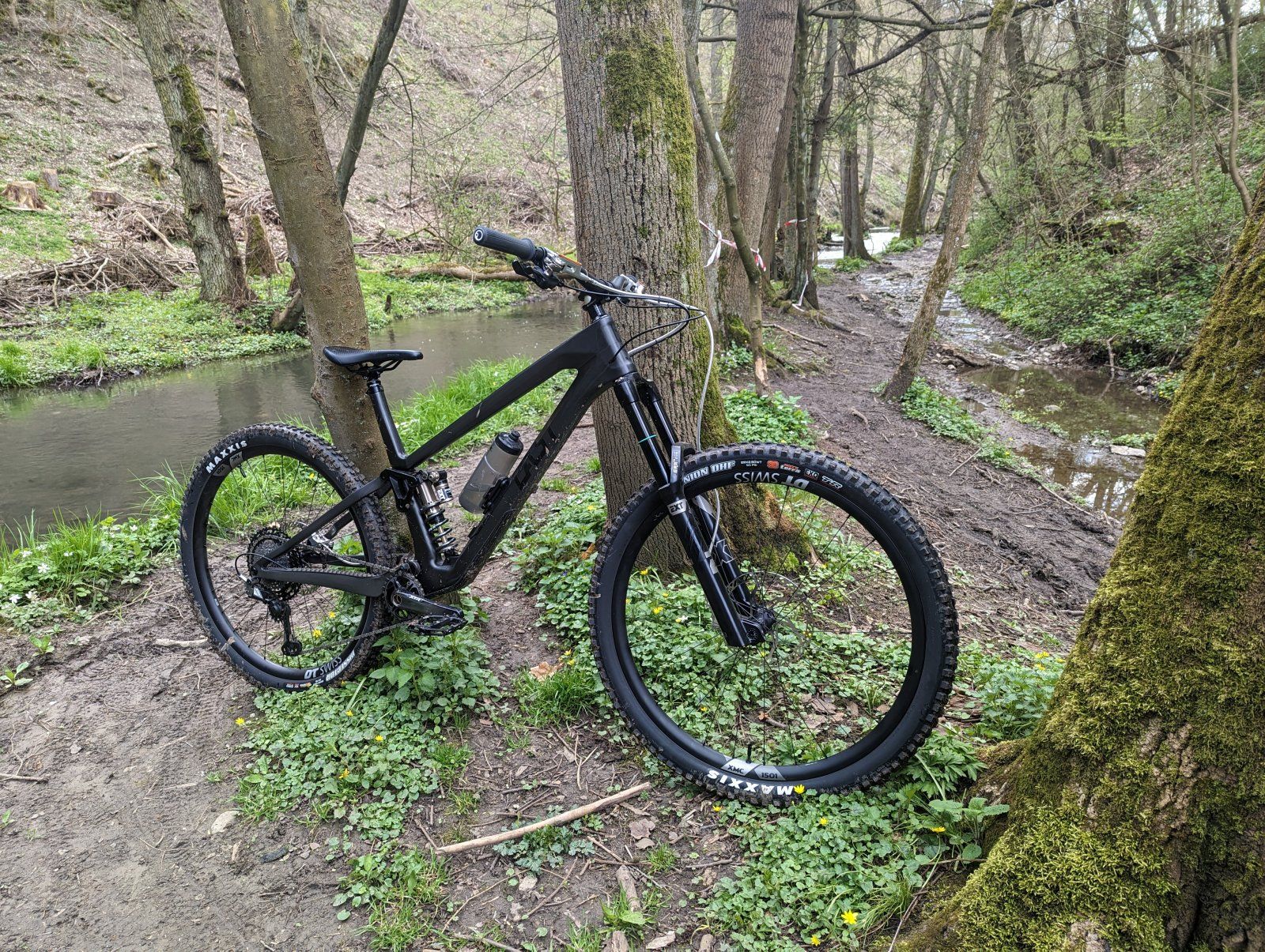

Gentlemen, I will ask here as the most active thread.
I am riding a Tarvo with an Era V2.
After playing around I still can't say that I am 100% happy. Support of the fork is great, but there is no small bump sensitivity at the start of the stroke, and that's what I wanted in the first place from the Era, with the coil and dual chambers. The fork has not seen any service yet, and I might be the lucky guy with the tight bushings.
Where would you recommend I send the fork for service and setup? I am in CZ, we have a local distributor but I would prefer DE guys with more experience. I keep hearing about Marco, is that Marco at EXT Italy or someone else?
Alternatively I am thinking about trying an Edge. I love the serviceability Vs EXT and the stuff guys make, not worried about flex, and I am sure intend will be smoother off the top, but I am not sure I will get the support I want. I am around 95kg on a 195 Tarvo V2 (so I could go to 180 with the Edge).
Or should I give the Era another chance after a proper service? It was a very short season for me so far due to traveling but I am just not getting what I expected from the fork.
Pic of bike = no stress
Nice looking bike 👍🏻
Can't help you a lot, but Marco is the EXT distributor in Germany (located in the area of Frankfurt).
https://schnurr-tech.de/

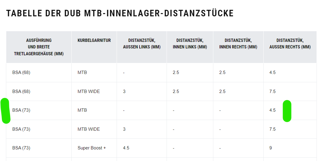

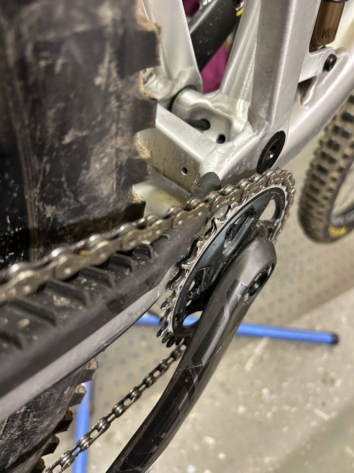

Guten Morgen liebe LAST Gemeinde, seit letzter Woche bin stolzer Besitzer eines Glens.
Soweit hat der Aufbau prima funktioniert nur scheint mir das Kettenblatt sehr nah an der Kettenstrebe zu laufen. Montiert ist ein SRAM DUB mit Descendant Carbon Kurbel.
Laut Manual ist rechts ein Spacer von 4,5mm vorgesehen und so montiert.
Es schleift zwar nichts -aber ein 32er Blatt würde m.E. nicht mehr passen.
Habe ich etwas falsch gemacht oder ist das so richtig montiert?
Vielen Dank für euer Feedback.
