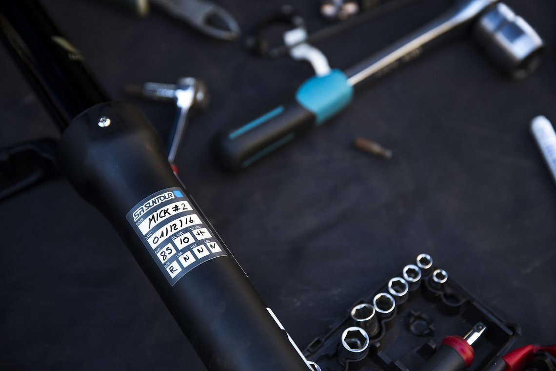

Auch Tracey und Mick Hannah freuen sich auf die neue Partnerschaft:
I’m excited to develop a new relationship with SR Suntour! So far the performance has been very impressive! It has a good balance between comfort and support and I love how tunable it is which means we can have a great setup on any course. – Mick Hannah

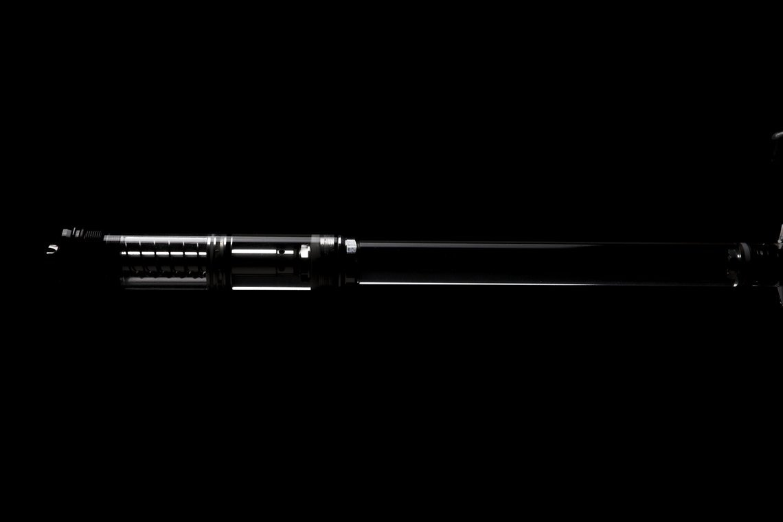

Auch was die Technologie der SR Suntour RUX Gabel angeht, hat das Team bereits sehr genaue Angaben zu machen, was ihnen an der Gabel gefällt:
One of the truly different things we are impressed with our SR Suntour forks is their 2 way of rebounds adjustment, having one rebound way set up super fast to go back as fast as possible to sag position and having another rebound way set slower when we need to have stability and traction towards the end of the travel recovery. If you add to that a super reliable manufacturing and a modern compression block, it makes the fork having a lot more control and traction while still being super confortable while having a lot of support.
