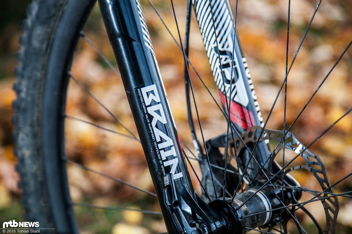

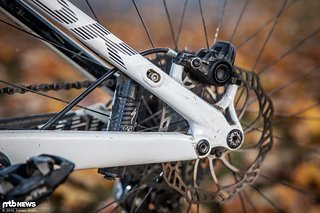

The Brain is really just an Inertia Valve design used to enhance fluid flow in compression (of a fork and/or shock). This type of valve can be configured to only active for wheel induced forces and remain in a closed position during chassis (or rider) induced forces. For the rider this means firm chassis control for improved pedaling and cornering while still allowing for an active, supple mode for improved speed carry and traction in the bumps.
The Specialized Brain forks and dampers are used to control the bikes’ suspension according to the current terrain and forces impacting the bike. How does the system work?
In the Specialized Brain system, an inertia valve is used as the control circuit that distinguishes between chassis and trail induced forces. The inertia valve itself consists of a brass valve that slides on a shaft inside the remote reservoir. As it slides, it opens and closes fluid ports. This brass mass is held in the closed position by a very light rate spring and nested in a way that prevents movement of the brass mass from chassis inputs but allows it to move extremely easy for trail inputs.

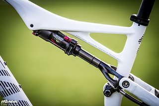

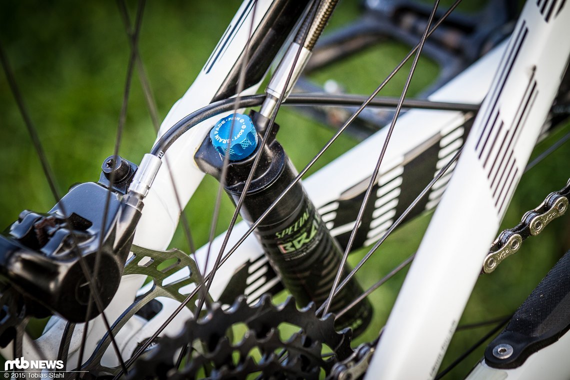

On the Brain dampers and forks, I can set up the Brain fade force but I am limited with regard to adjusting the high or low speed compression. Is there a way one can influence these on a given Brain-bike from Specialized?
You are correct; the Brain fade offers a free bleed path around the Brain circuit. To change high or low speed compression damping values, the shock would need a re-valve at one of our S-Tune service centers.

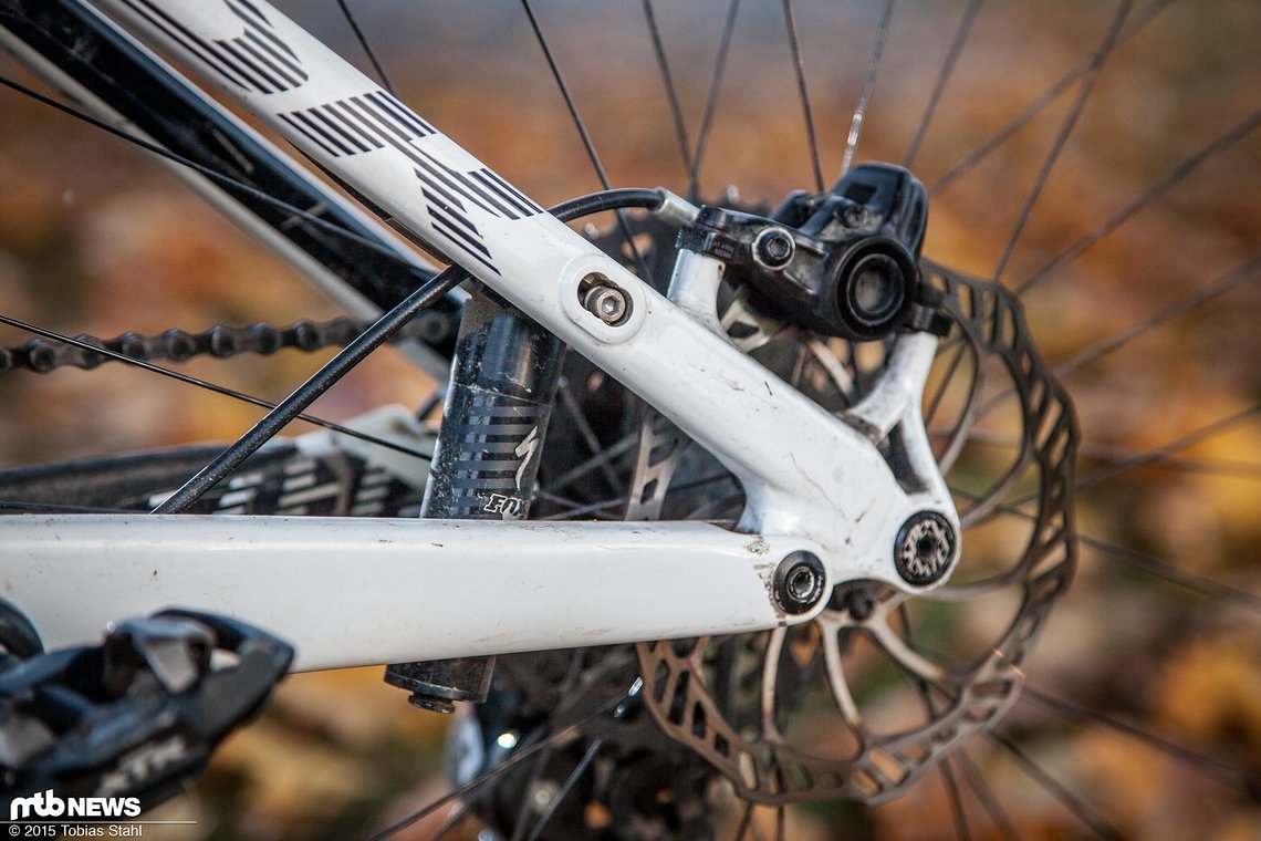

I spend a lot of time riding the Specialized Epic Expert Carbon World Cup for long term testing this year. While I liked the performance of the shock, the RockShox SID’s Brain damper disappointed me. In which way are the two dampers different from one another?

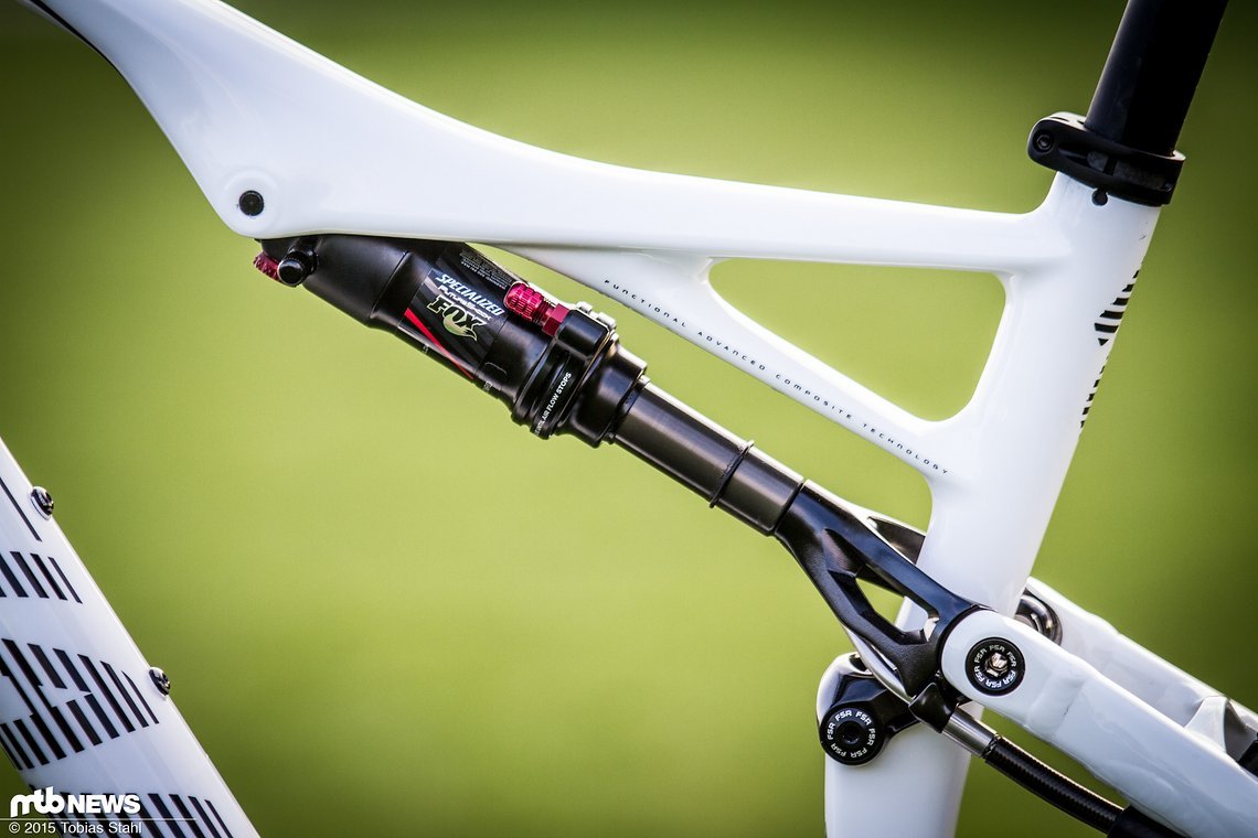

The designs between the fork and shocks are very similar in principle but the design execution, due to the packaging, is quite different. However, when comparing the value of this technology front to rear, for sure the biggest value is found when controlling the kinematics of the frame design for pedaling efficiency. Most of the XC Racers that run full Brain on the back will usually run less Brain on the front. The weight distribution over the wheels has a lot to do with this as well.
While the clickering sound of the Future Shock on the Epic hitting a bump while moving out of SAG (towards 0%) did not bother me, I wondered why the Brain fade adjust on the rear features 7 clicks while there are more than 20 on the fork. From a user’s point of view this makes a balanced setup harder than needed. How would you suggest to set up the Brain suspension on the current Specialized bikes?
We run into this a lot even on the other bikes. For the Epic, as I described above, it’s not always a direct correlation between the fork and shock so having the adjuster in sync was not really necessary. For set up, we recommend opening up the Brain Fade front and rear and setting the sag first. From there, I’d suggest starting with full Brain on the shock and maybe max–3 to 4 on the fork. From there a rider can easily season to taste.

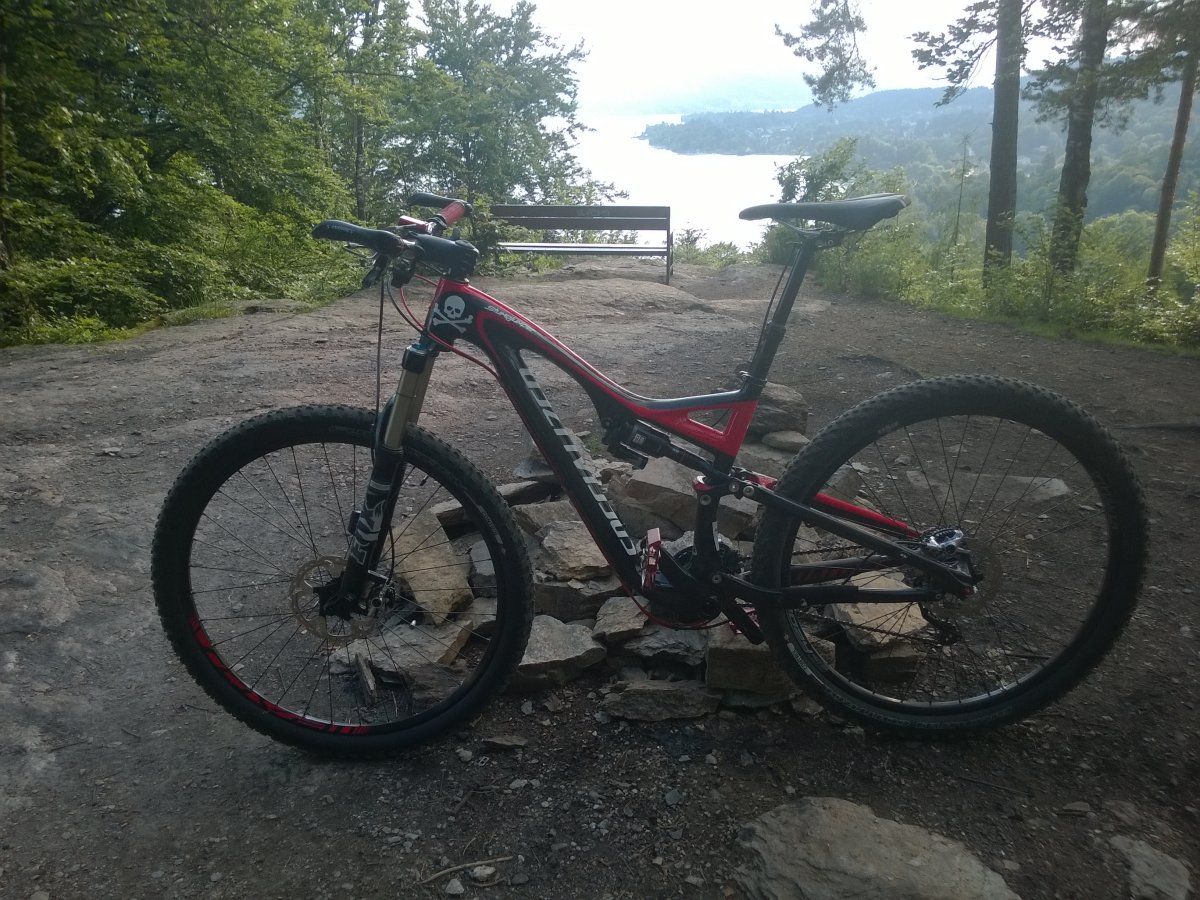

» Alle Kommentare im ForumMich hätte noch eine Nachfrage interessiert, warum die bei den neuen Stumpis kein Brain mehr verwenden.
Kann ich mir vorstellen. Welchen Jahrgang fährst du?
Bei meinem vermute ich mal, dass ich den Plus nicht rein bekomme. Ich hätte gerne einen Dämpfer, der sich leichter auf mein doch etwas höheres Körpergewicht anpassen lässt.
Aber der 2006/2007er Rahmen hat ja diesen Durchbruch durch den Rahmen, wo ich Probleme für den AUsgleichsbehälter sehe. Kannst mal Bild machen? Sowas würde mich auch interessieren. Den zusammen mit einer 140er Revelation ... das würde schon deutlich was her machen.
Ich habe einen 2013er Carbon Expert in Größe M. Der unterscheidet sich natürlich vom 2006er.
Ich verkaufe den 2013er übrigens, da ich mit dem Fully nur wenig gefahren bin (ca. 1000 km) weil ich damit einfach nicht warm wurde und auf den Fatboy umgestiegen bin.
Wäre gerade Budget über, könnte man ins Gespräch kommen. Leider ist er aber auch ein wenig zu klein. Ich fahr lieber L-Rahmen. Aber danke für den Hinweis.
