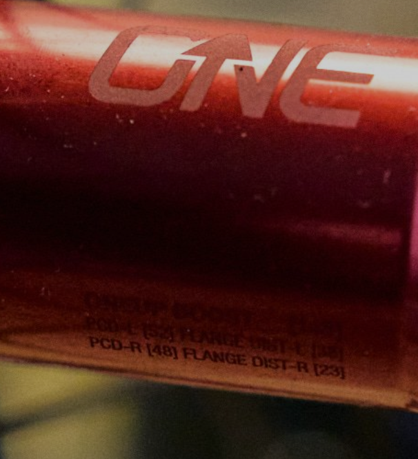

  5. Nettes Feature für Laufradbauer:
    Das liest sich auch sehr gut:
    If you want to replace the bearings on the rear hubs, a Shimano cassette tool gives you access to the lockring on the non-drive side. The bearings come out and go back in from the non-drive side of the hub. This is a clever bit of engineering allows for easier home maintenance.
